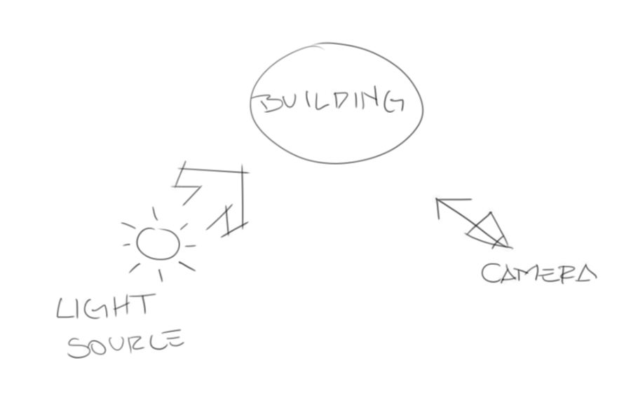

The Shadows sharpness depend on the size of the light source. Usually hdri files have a big bright sky that cast soft shadows, but they also have one specific side that is brighter. Try to rotate the hdri texture in a way that this brighter side be positioned like this scheme.
The good thing is that you are using octane render and you can rotate the image real time until you find the best position for the hdri texture.
The camera set up can help you too. If you decrease the power of the hdri map and increase the exposure, fstop and ISO of the camera you might get better results.
