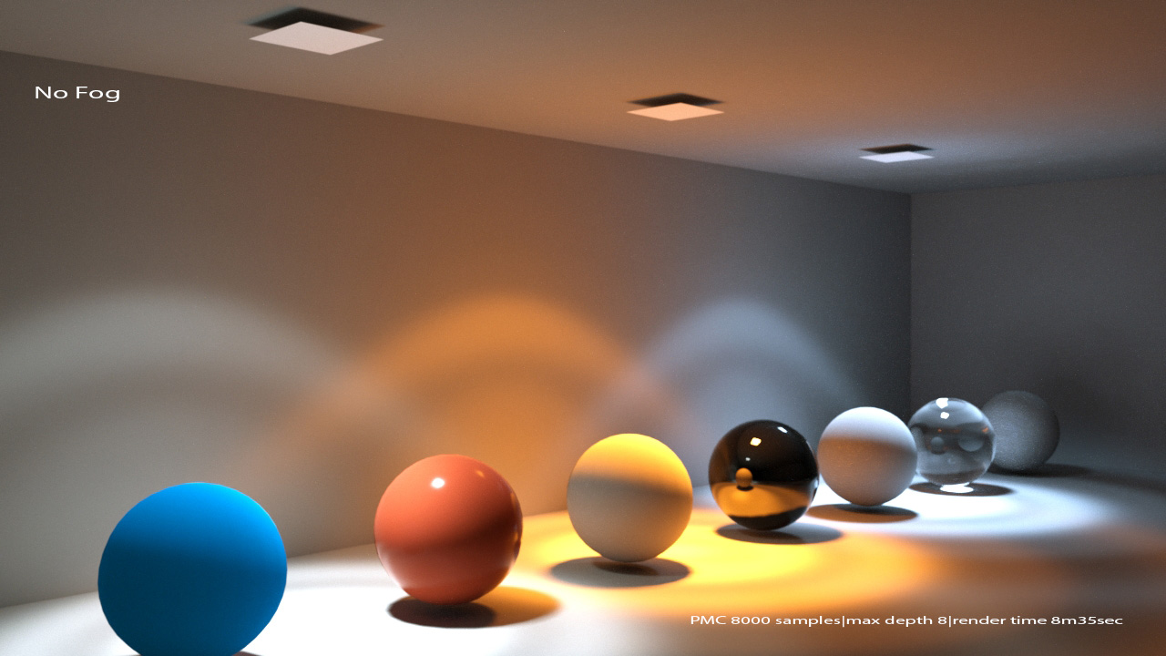

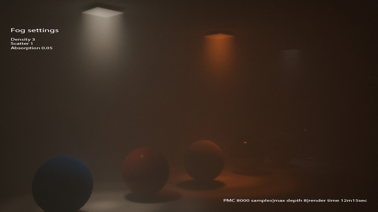

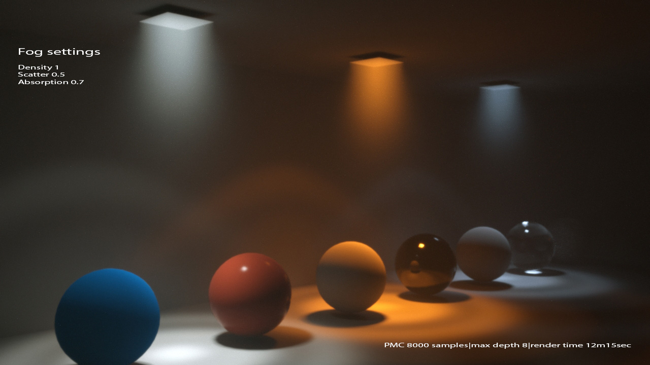

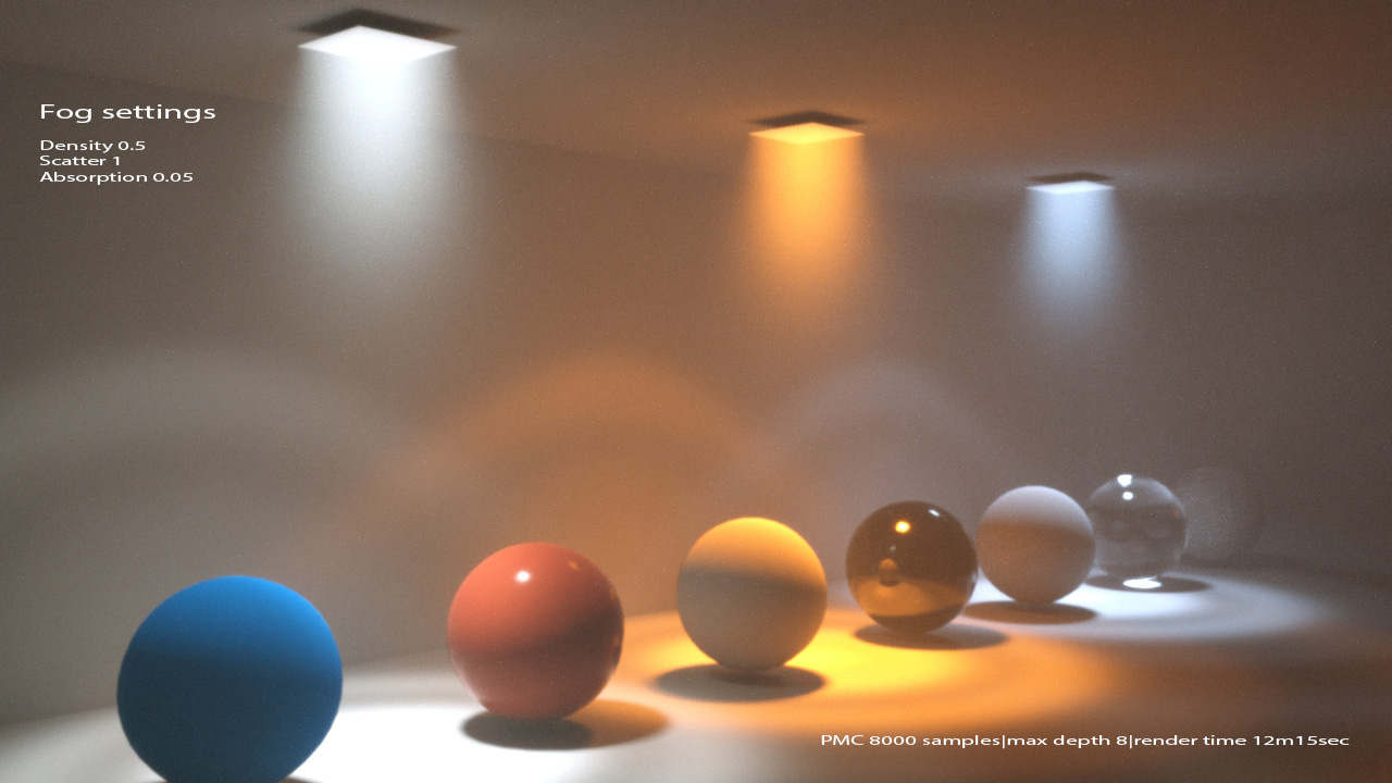

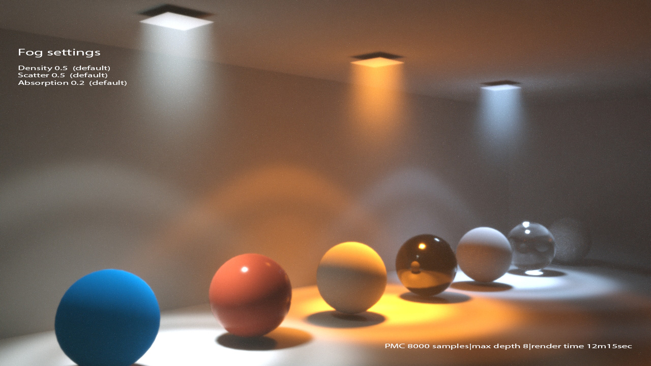

I have included some images as examples of some of the settings.
The render times noted were all rendered on 4 x GTX580's
The size of my test set for these images is 2.1m from the center of the blue sphere to the end wall, so not very big, making the fog in all my examples quite dense.
