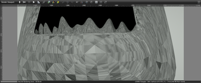

I'm still having problems with faceting. The new plugin, beta2f, didn't help. When I mess with the "native unit size" setting (ie set it something different than the maya scene settings), it sometimes helps, but not 100%.
Here is what I am getting when I hit the render button in the Octane menu (attached), notice the circular noise pattern over some of the geometry :
@jboris
Aha! So it's not just me that is seeing the circular patter!
I just found out that you need to set the unit now and it got rid of the circular pattern. I normally set the unit size to meter (Maya's native, I believe) before hitting render.
With faceting, I don't have issue. Basically I always enable the Smooth, providing I set the face to whatever I like in Maya first, before exporting to Octane and make sure I did Normal-Conform in Maya.
- J
