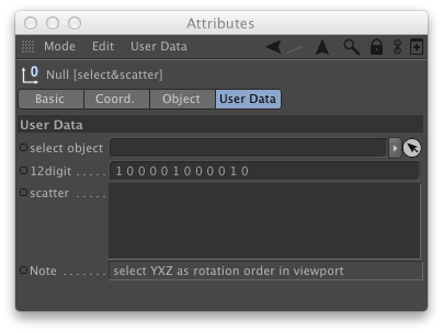

basically there are two null objects with an xpresso tag.
the "select&scatter" object has a user data section with an imput object field, you can drag any object in it from the object menager or pick it with the proper dropper. now you can copy and past the 12digit string inside a scatter node or in the text field below, where it's possible to store several strings of different position, rotation and scale of different instance.

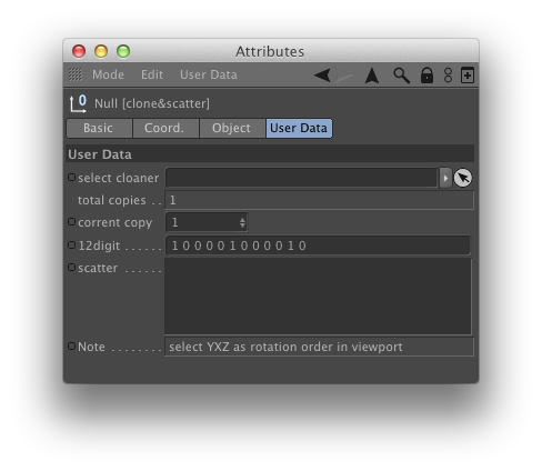

the "clone&scatter" works in a similar way but with cloners.
when a cloner is dragged inside the first field, the total number of copies is displayed and is possible to choose a specific clone and obtain the 12digit string.

now is possible to obtain automatically all the matrices of the clones of a mograph object, it's a bit tricky but it works.
here is the procedure:
- download the "octane-scatter-v04.c4d" attached to this post
- copy and paste the two null objects with the xpresso tag in your scene
- very important, select the YXZ rotation order for both the xpresso in the hud of the viewport, otherwise the generated matrix is not correct
- drag the cloner to be scattered in the proper field in the user-data tab of the "clone&scatter" object
- read the total number of clones in the field just below and use it to set the duration of the animation in the timeline subtracting one frame
- go to frame 0 and set a keyframe with the value of 1 in the field just below
- go to the last frame and set a key with the value of the total number of copies
- go to the animation menu and set the play mode to simple to avoid the loop
- open the console window in the script menu and clear the content from the file menu inside the console
- click play and voilà, in the console appear the matrices already formatted and ready to be paste in the scatter node

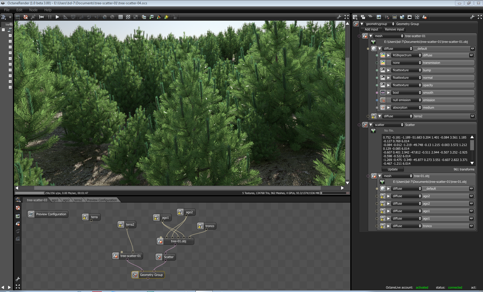

and here is an example of a pine in a mograph with 961 clones over a landscape object:
ciao beppe
