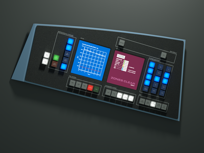

Here are images of both the render, and the setup (nodes, nodes settings and an image of a pushbutton wireframe to get an idea of the poly counts. To try to test for speed vs. poly count, this version has a relatively low number of polys yet still takes 22 hrs to finish rendering at maxsamples = 64000, but only because of the pushbuttons. Everything else in the render clears up, noise wise, very quickly. At the end of the render, the pushbuttons still have a long way to go. The black panel surface might look like it is noisy too, at first glance, but it is actually a ridged fractal texture:
I am running a batch job of six renders to composite in PShop to get the noise reduced. I know there is a procedure for dealing with noise that was posted some time ago, but this test was already setup and in the process of being rendered. I have the nagging suspicion that that procedure would not work in this case if only because the noise removal rate on the buttons is so poor.

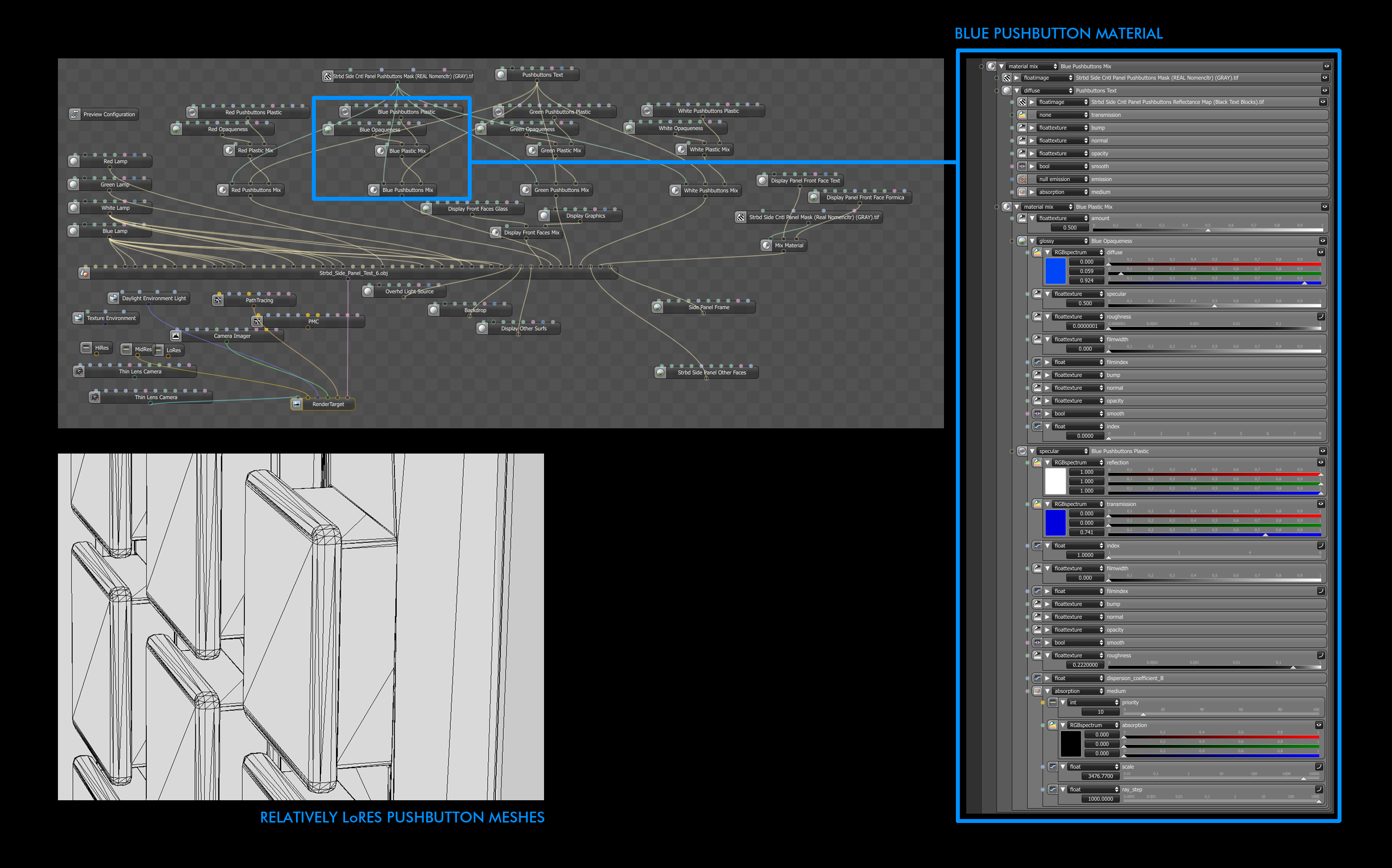

Here is the setup:
One item of note...I used a material mix to get the unlit button color to be fairly intense. This was only done when I was still working with a subsurface scattering approach, because subsurface would not allow me to get a really bright colored plastic texture. Since I have since nixed the subsurface idea completely, I MIGHT be able to dump that extra "layer".
