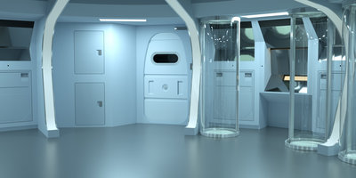

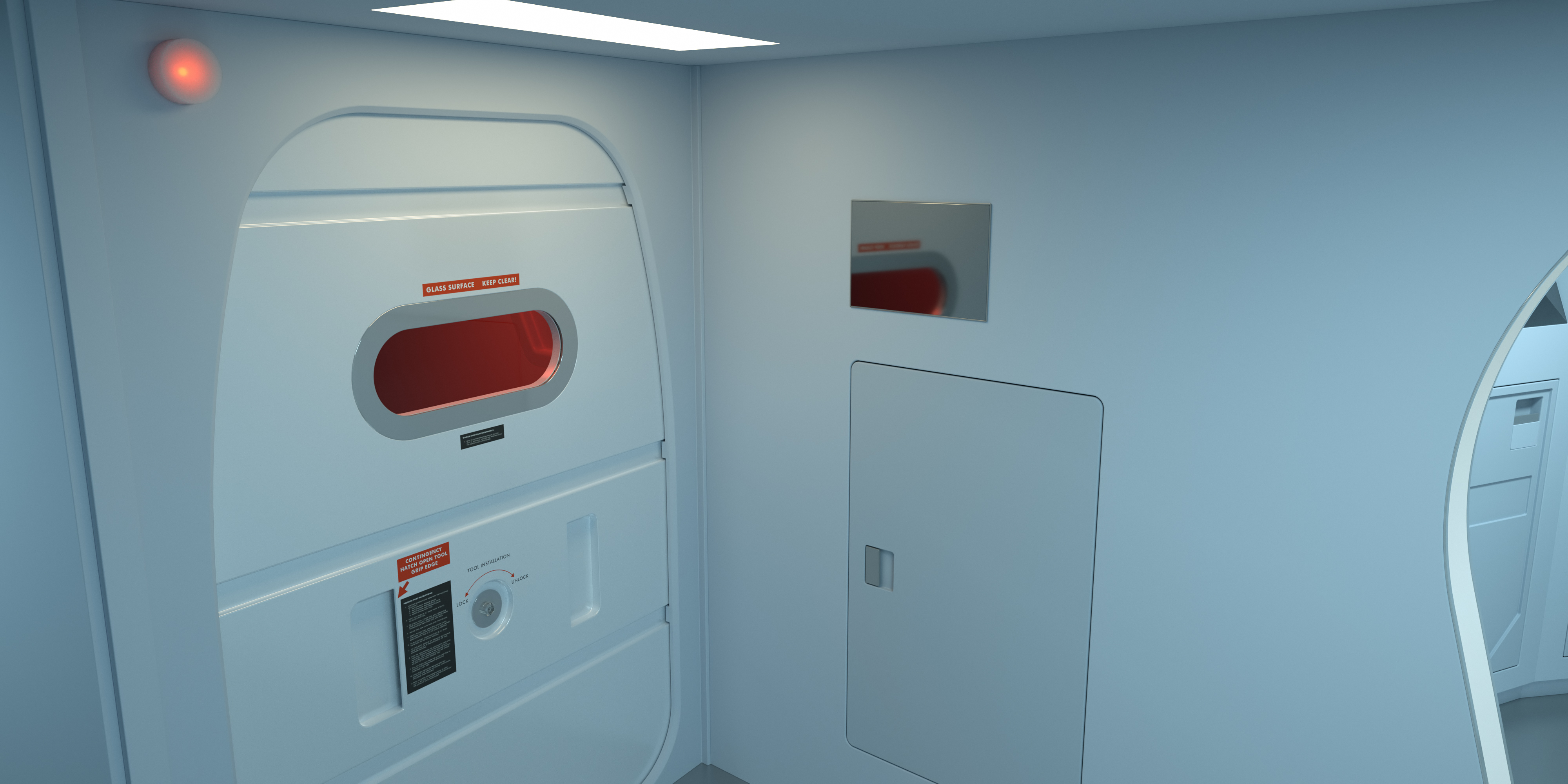

Here are two renders that were maxing out my 2Gb memory on my 560. These are from my revisionist, Lost In Space, Jupiter-2 project. The airlock closeup (about 4.5 days) not as bad as the overall shot (8 days), but the airlock shot had numerous decal textures applied. The overall shot had no decal textures and it would have been a real challenge to get them into the memory space. For the way I like to work, I really need a MINIMUM of 3Gb. 580s would allow me to do that.
I still had to do a little bit of NeatImage noise removal for both, so I estimated roughly 12-20 days for complete noise removal through rendering alone.
All of those glossy black panels are touchscreen control panels that don't have emitter graphics applied yet. A couple of fire extinguishers are not present yet and there are supposed to be zillions of decals everywhere. So these are unfinished.
