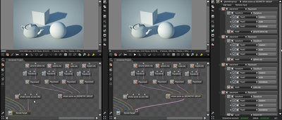

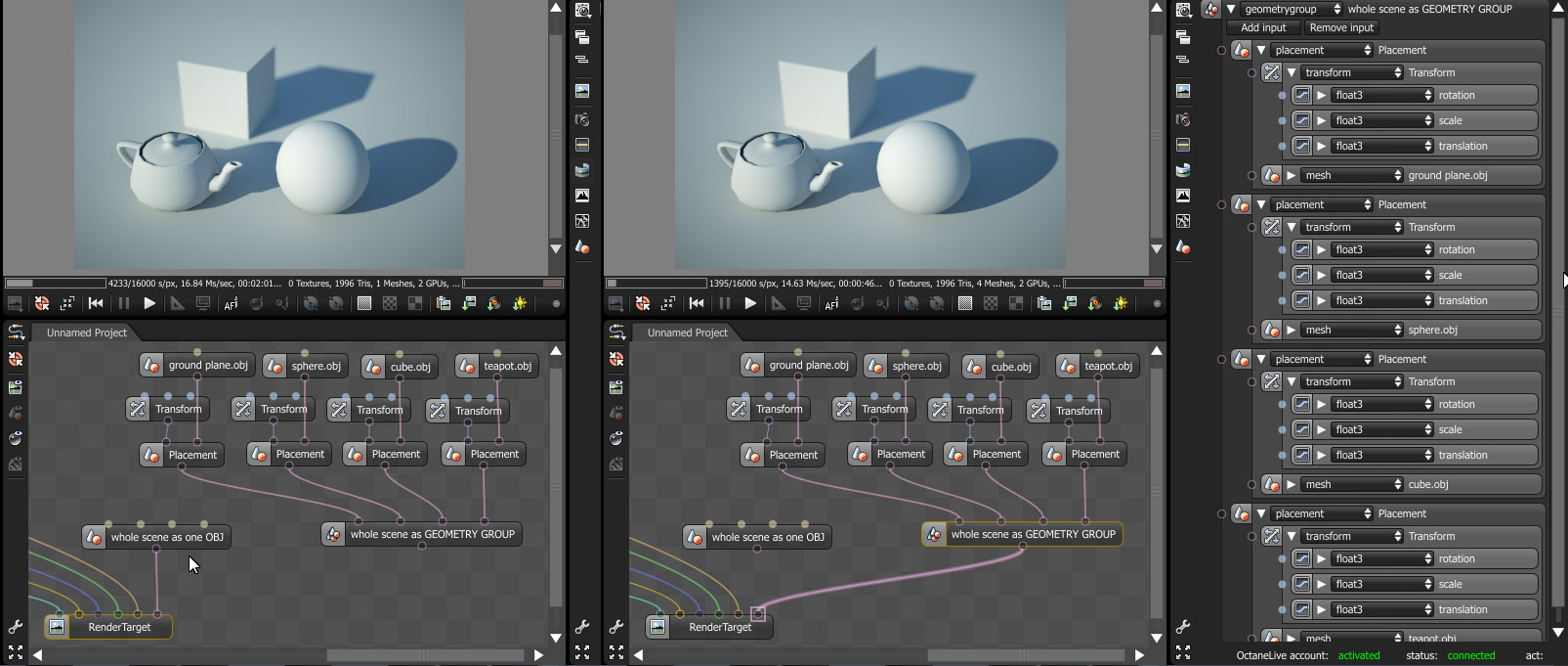

m_m_, You need 1.025 version =)
before, we could only import one mesh onle - parts in it would stay fixed, You could not move any of them.
But You can divide the scene, import separate objects, conect them into group through placement node (with transform conected) and have the ability to move them independently.
Check this pritscreen =) that might help You.
Cheers.
