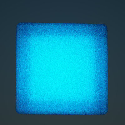

I have been experimenting with backlit pushbuttons, but have two issues that I cannot find a solution to. I am wondering if anyone has had the same problem? The first problem is that, as you can see in the image, light is not scattering into the button edges like it would in real life. It is practically opaque in those regions, and any settings for scattering have no effect on it. I can drop the scattering down to make those areas more transparent, but then I lose the scattering effect that I need.

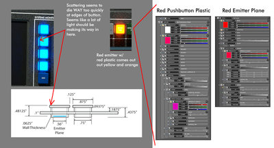

The other problem is that making red pushbuttons with red emitter planes, they always come out yellow and orange, even if I take out ALL green and even add a bit of blue to drive the color over into the cooler side of the spectrum:
Emitter plane and backlit pusbuttons

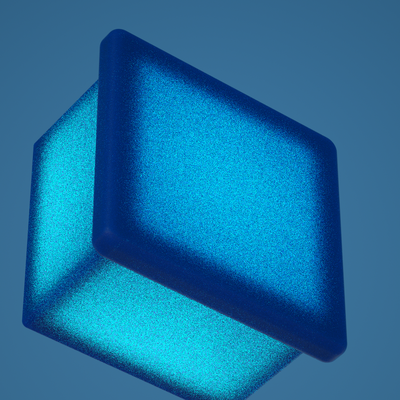

This test seems to indicate that scattering does drop off too quickly. If the wall thickness is 1 unit thick, then the distance from inside corner to outside corner where any two sides meet is 1.4142 units. That's not even 1 1/2 times the wall thickness, yet the reduction in light that is able to escape the pushbutton at the corners is way too low. So clearly, at the top of the pushbutton where the "roof" overhangs the pushbutton body, light scattering doesn't have a chance in there, if scattering is diminishing as quickly as in the corners:

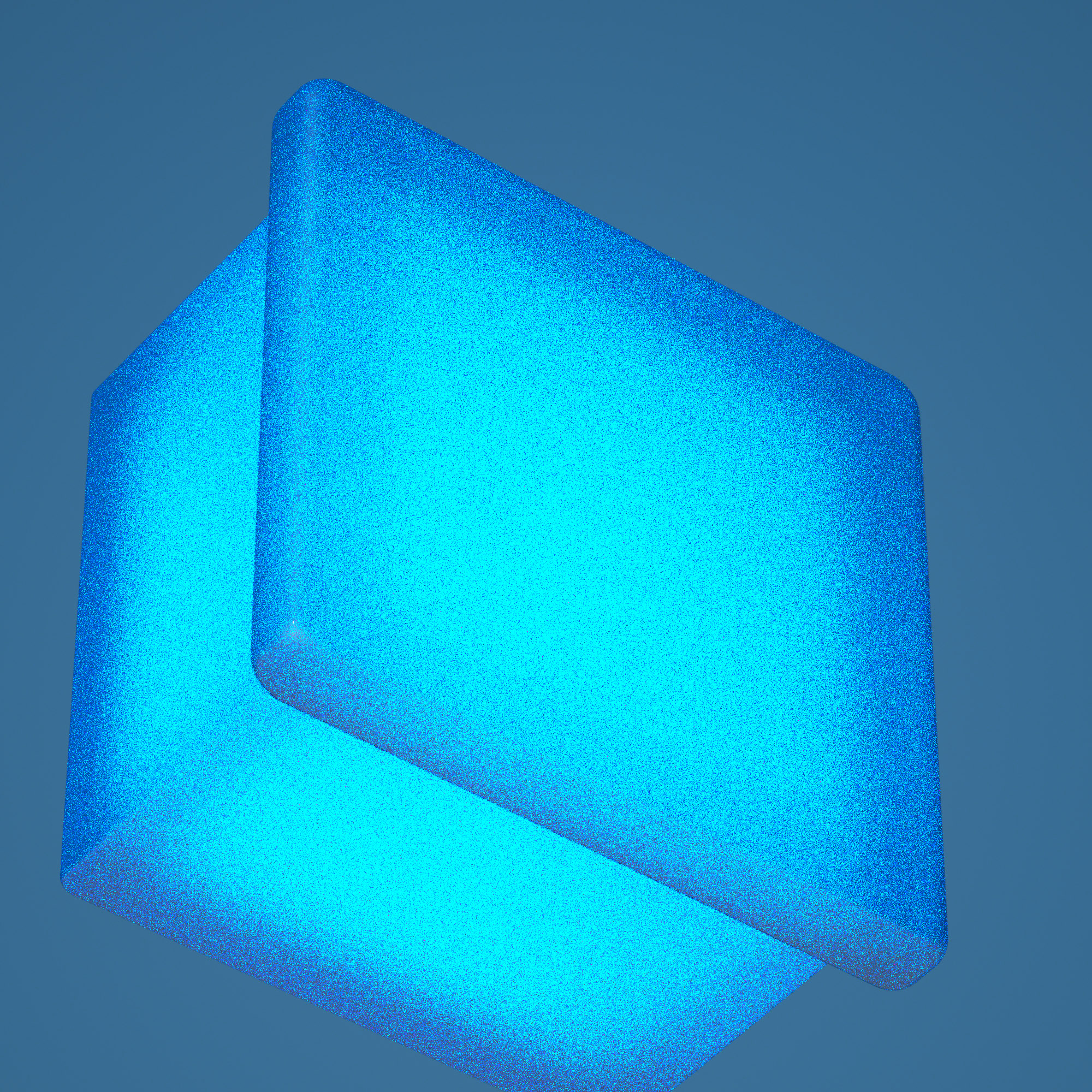

Setting index to zero helps a tiny bit, but not really any great improvement. It's almost as if scattering is only bi-directional, not like photons scattering in all 3D volumetric directions at once. If so, that would explain why the overhang is not getting any light scattered into it...when the photons are scattering, they are only scattering in two directions...back towards the source, and away from the source...not off to the sides?

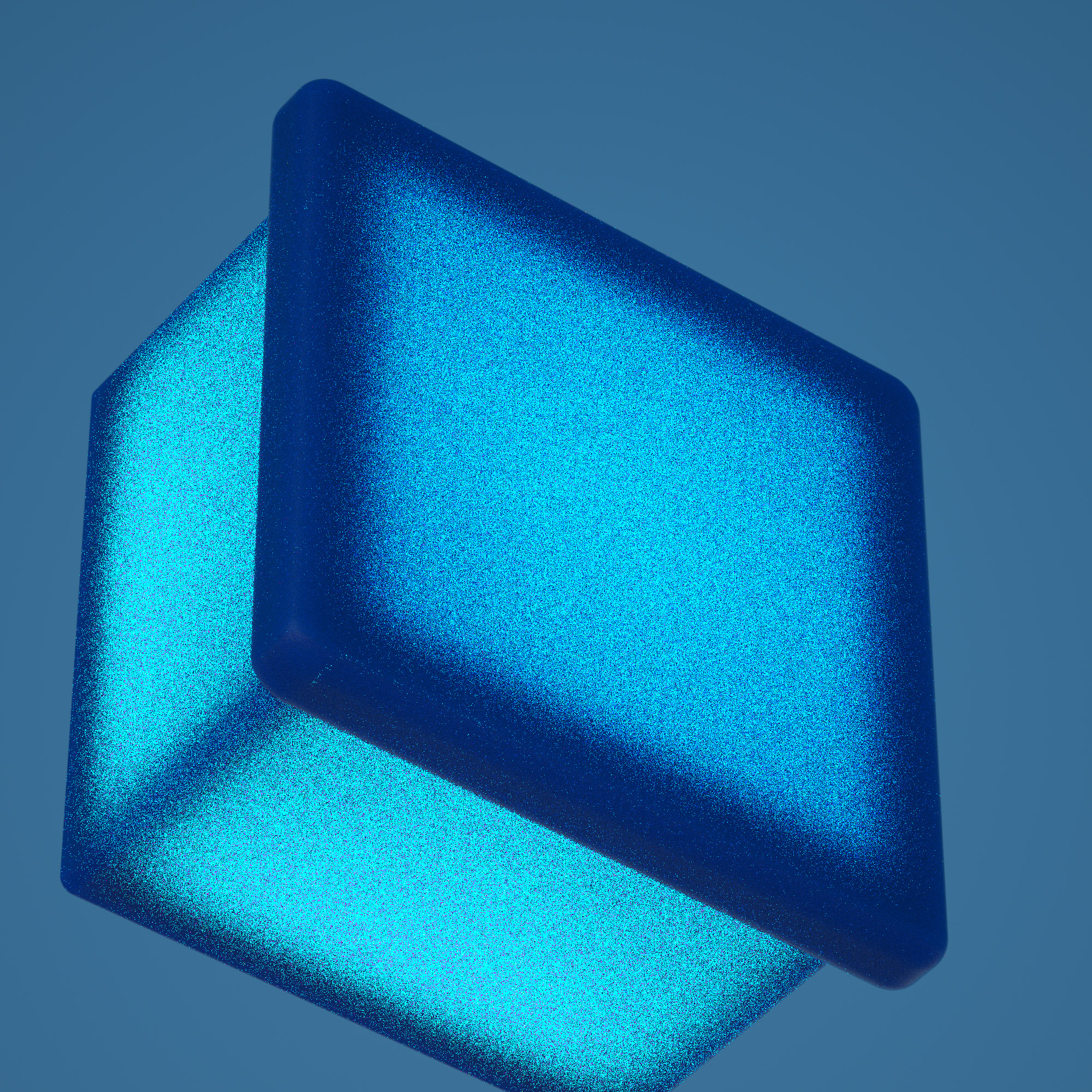

You got me thinking now...I decided to dump scattering completely and go with absorption (but set to zero). I then went with very high roughness and set the index = 0. Then, in order to get a glossy reflective surface to the pushbutton, I mixed that material with a glossy blue surface. Emitter color is pure white.I have the feeling you may get better results if you reduce the scattering and increase roughness...
This seems to work really well, but it still seems like a kludge to me. After all, scattering SHOULD work by itself, just like in a real translucent material.

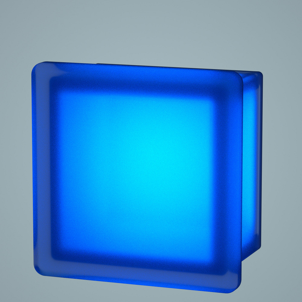

From a quick bit of research it looks like most of these are actually quite smooth plastic, with some kind of backing that does the scattering.
Therefore you get a nice smooth looking reflection off them, but they still have a nice smooth glow from behind.
I'm guessing this is what you were going for with the mix material - so could be worth a try? Add an additional backing to the inside of the switch with heavy scattering and roughness?
The best i could come up with in my short time was down the same road as you. Use absorption to help color the switch, but i did add scattering, with direction almost 1.0 (straight through).
This seems to come out quite nice - although perhaps not quite as "glowy" as you might like.

That's actually really beautiful looking. I like it a lot.
On the material mix...The switches are smooth glossy translucent plexiglass with no backing, actually. So translucent that you cannot see through to any of the other surfaces. So they differ from most production switches I suppose. In my case, I was trying to copy that translucent plexi look. VERY very cloudy. Much more than in your example. Would you say you used a 50/50 split between roughness and scattering?
Basically, it appears from what you did and what I did that scattering has some severe limitations by itself. It still seems that the scattering algorithm does not really propogate well to the sides of any photon paths...In other words, it looks like scattering either goes forward or directly backward, and not straying too far from that 2-dimensional path. 30 degrees, maybe? I had the same problem in Maxwell, except that I gave up there since it took forever to see the results and make changes.
Based on what you did, I am going to play around with this more.
