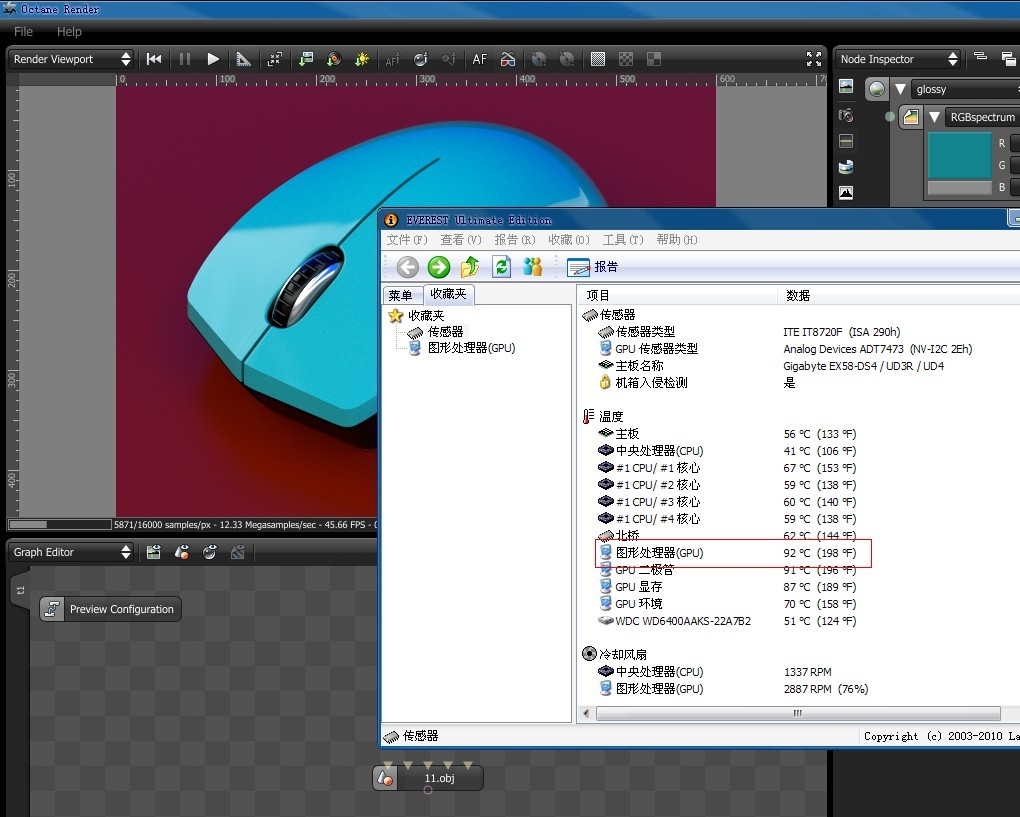

My GTX470 at high temperatures, it long time work can?
Temperatures up to 91~92, I have to worry about this. :?:

nickliang wrote:My GTX470 at high temperatures, it long time work can?
No problem.
Nope. It is within spec up to 105° C.

You can drop it 5~10C by box's lid off, too.

You can download "MSI Afterburn" and use a custom curve to control the fan speed. My card's temperature usually doesn't exceed 75 degrees thanks to this.
