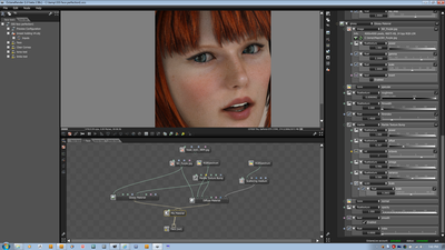

I have finally (after weeks of work) figured out Octane enough to be pretty proficient at it,and now my quest is to create a realistic skin shader.
What was missing from my skin being realistic was the "3D" effect of real skin and pores and subtle skin defects.
In this render, I have created a good enough skin to show off Octane rendering of skin - and I am pretty happy at the result.

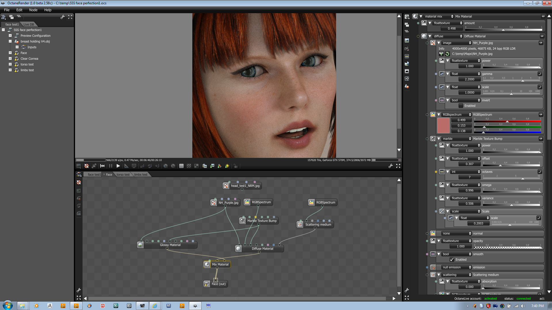

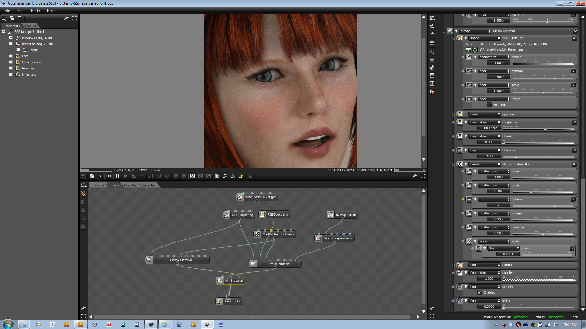

I am using a "marble" procedural texture node into the bump and with scaling, works nicely.
PMC with 2x texture image lights and a Texture Environment in the mesh preview environment.
I have tried bump maps (some I made) and several normal maps, and neither looked too good. I believe this marble procedural is better. Now I also believe one can create complex node maps to enhance this effect.

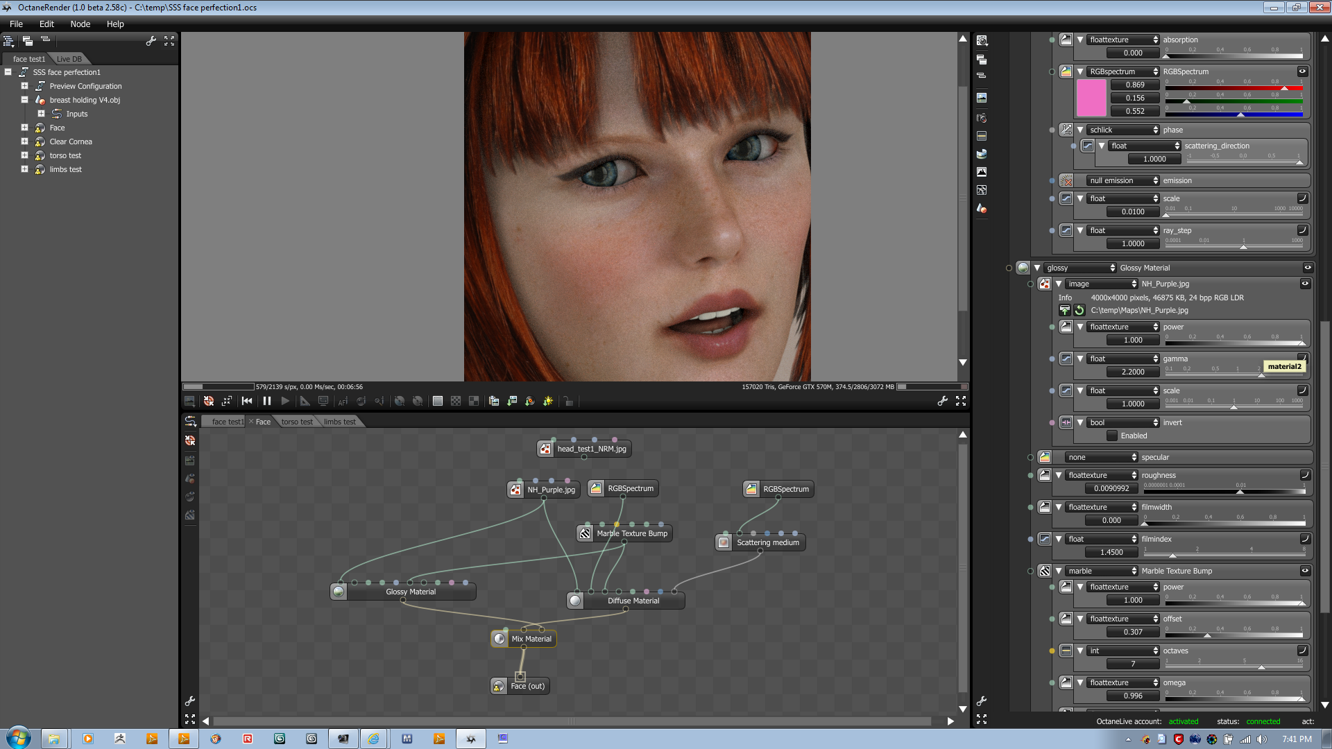

Nice work! Looks great. This setup is very similar to the setup I came up with for skin.
My Material Mix was set to 0.75 - biased to the diffuse. I like your 0.5 setting more.
For bump (for body rather than head), I used Turbulence (0.005 power, 3 octaves, 0.001 omega, scale 150).
I had scattering direction set to 0 (you have 1). Doesn't that mean you are not getting any backscattering? Or have I misinterpreted that?
Also, you have got glossy specular set to None - when I do this I get no glossy at all.
