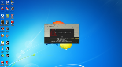

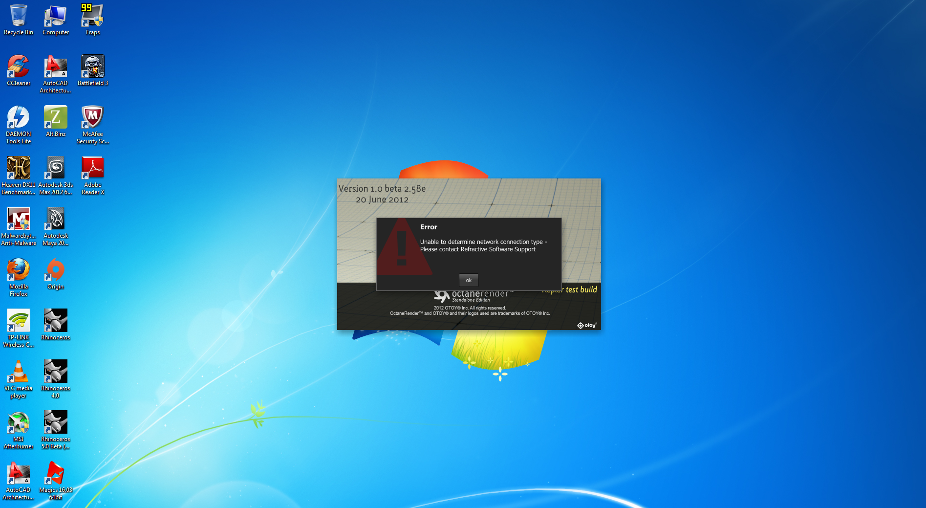

Hi guys recently reformatted my computer and after reinstalling octane i got a Error message saying 'Unable to determine network connection type - please contact refractive software support'. Anyone got an idea for this?

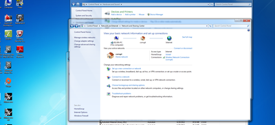

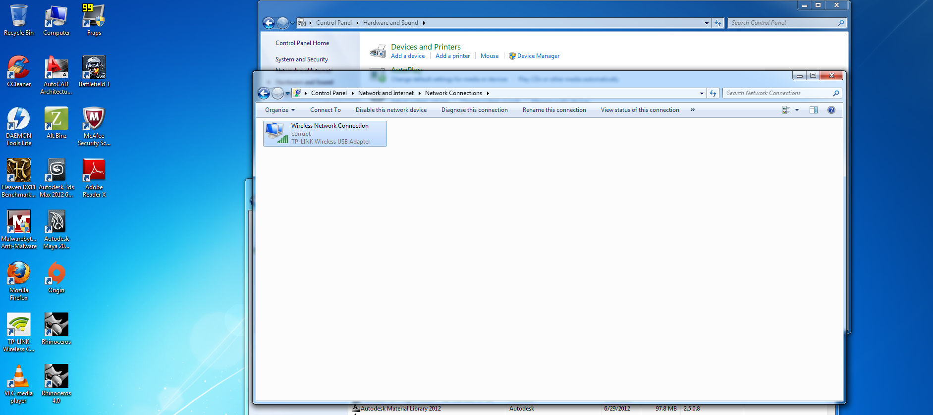

hi thanks for the reply, this is what i see from the adapter list. That is my network connection.

franchais: your screenshot shows no wired network adapter. Octane requires one to be present but it doesn't need to be the active network connection.
Open Control panel → device manager (search it in the start menu), and see what devices there are listed under Network Adapters. Switch on any disabled network devices and if a device is not working, you may need to install the drivers.
