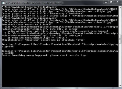

I took the reference Model from Mike Pan (BMW 1), unpacked the textures into files and got this
console notification.

You probably have a material refering to a non-existent texture. I'l give a try myself when I've some time.

Look at object TireRubber and destroy texture slots #2 and #3, these are wrongly defined.

liquid orange wrote:Thank you yoyoz. Is there a possibility in Blender to delete all existing textures or materials? is this an exporter problem or an octane one?
Not sure there's such a mechanism but you can give a try to the 'clay' plugin that should be able to assign same material to all objects; Not sure by the way it would clean the texture slots properly.
Octane has nothing to do with this issue. I could put more checks into my code, but you may missed some important information about what is wrong with your blender file, as you should never have an undefined texture slot 'open'...
