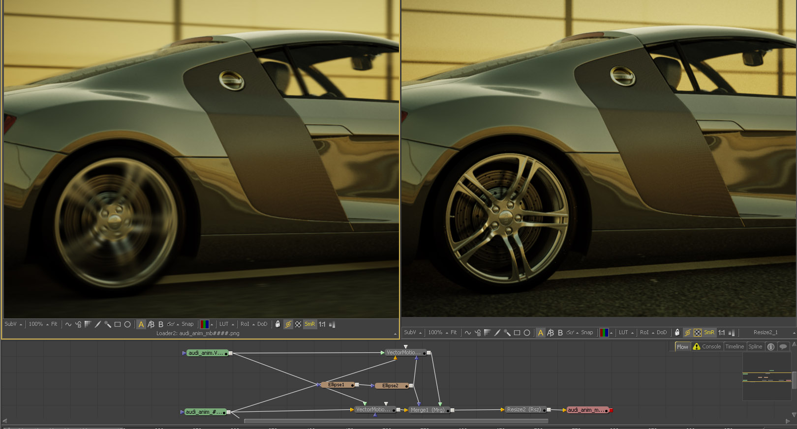

Average rendertime is 4 min per frame 2048x1152 on gtx285 (actually it takes 6 min per frame - 4 min for render + 2 min for export/inport). Vector motion blur was added in DF via velocity channel (which one was rendered from 3dsmax), and then video was downscaled to 1280x720. There are some artifacts inside because I forgot to adjust some materials (and these ones are glass by default).

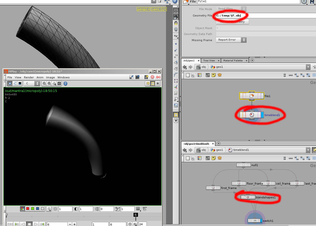

4. OBJ Reader (or separate timeblend node) should be able to blend adjacent obj files in sequence to get geometry motion blur (I attached picture of houdini implementation)

Nice, it's like knight-rider, there's nobody behind the wheel ;)
very cool.
you should try to add some vector mblur in post.

Actually there IS vector motion blur already (see screenshot).

I'd prefer fair 3d motion blur, but motion blur pass would be great too.
Do you mean velocity pass? It's impossible now because single obj doesn't have any information about vertexes velocity - we need:
1. obj sequence reader + blend between frames
or
2. exporter from 3d software which exports to some special 3d format with vertex velocity channel (not obj)

3. or maybe MDD Support ?

I've never used .mdd format before. Is it closed commertial solution developed by PointOven creators?
