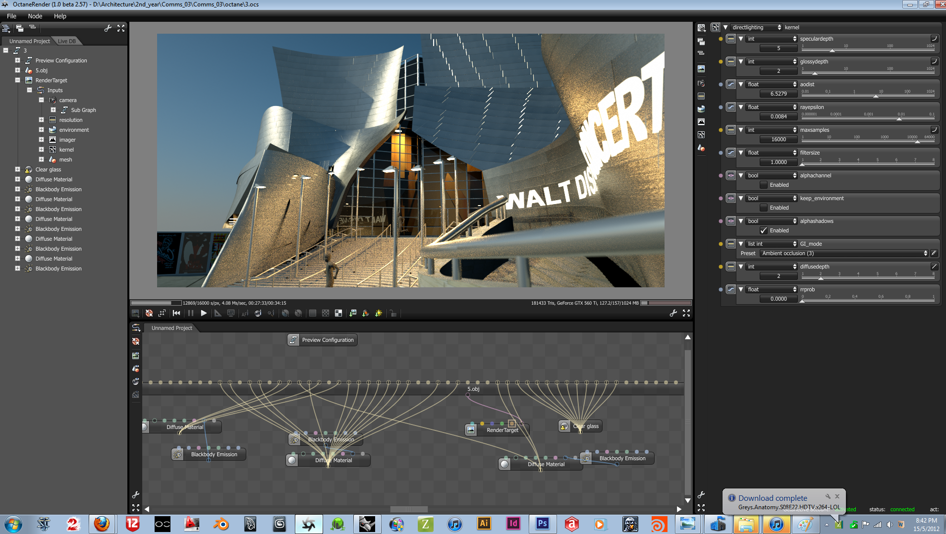

Hi guys not sure if this is the right forum, but i would just like to ask about a problem that Im having when rendering with light and night renders. I get alot of noise or specks on the scene, how can i remove them and what settings should i change? Thanks!
Oh ive attached a picture too.

hello franchais,
can you tell us what kind of lightning are you using ?
Smaller light sources will give you more noise and it will take much longer to get clear image
did you use IES lightning ?
I see that you used directlightning and that you didnt spent a lot of time whaiting
try PMC rendering engine and whait longer
use architectural glass cos its exterior, from livedb
avoid shiny materials cos they produce fireflys
use bigger render size and then resize it down to get cleaner image
