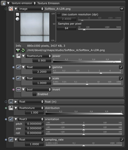

So, I try to lit an object with an emitter representing a softbox. The emitter is a plane with texture emitting surface. The texture is applied to diffuse color of the material and efficiency or texture of the emitter node. The settings are:
The imager is set to linear with gamma & exposure at 1.0. The environment lighting is a texture with intensity 0.0 - ie. no env light. I used pathtracing with 32 samples.

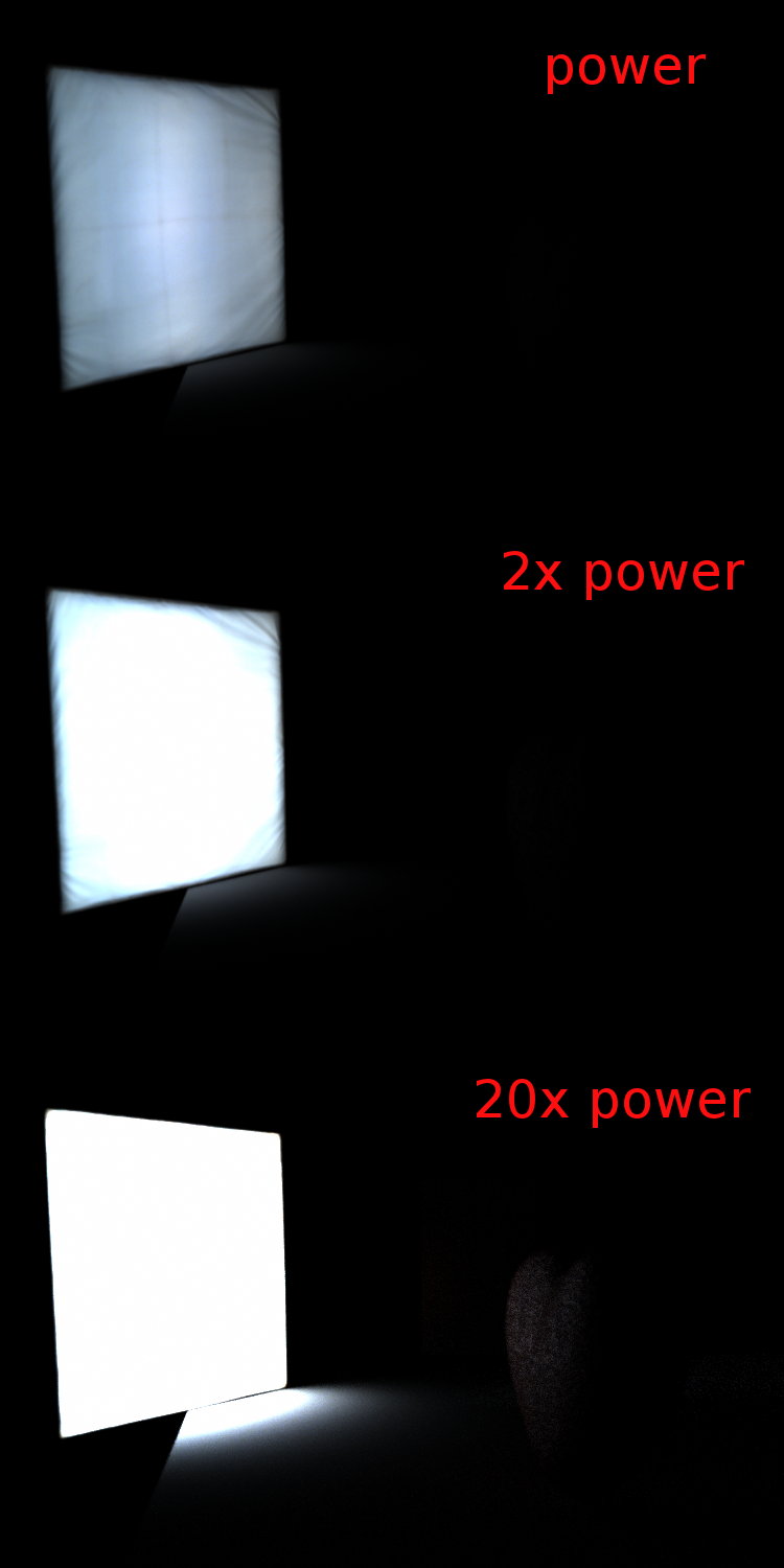

The original power of the emitter (1.0) gives a proper visual appearance of a softbox, but to get any illumination on the object you need to use 20x, 50x, 100x more power which completely burns the emitter appearance (and thus its reflection). And even at 20x the power the object is still very dimly lit, almost invisible. The scale relation of the emitter and the object is something like trying to illuminate a person torso in a studio.
Is this behavior realistic? Am I missing something? It's possible to illuminate objects without completely over-exposure the emitters?

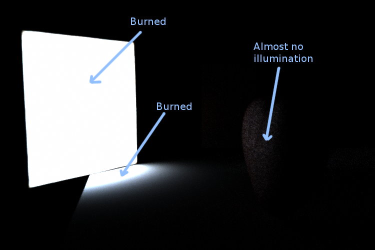

I find this light distribution really strange. The emitter and everything in the immediate vicinity is burned, but the object (which is at emitter width away from it), is almost not lit:
(the object's material is just a diffuse + glossy mix brightly colored, nothing unusual)

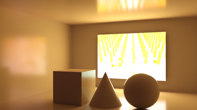

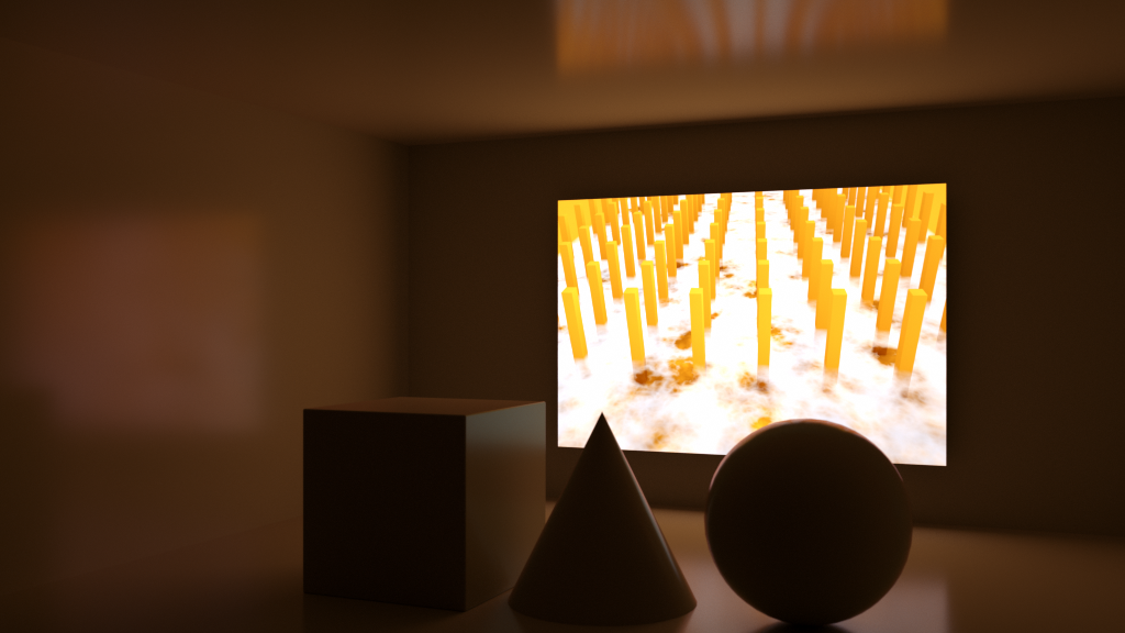

Posts: 10507
hi matej, i have made a simple test with an open box, some geometry and a plane with a texture emitter; the environment is set to 0, the emitter at 1 watt.
all seems to work as expected, probably because my texture is similar to a tv screen; your situation is a bit different, also in real photography if you exposed to see the soft light all around is black and viceversa.
the only solution for you, i think, is to create two planes, one with the soft light and the other with an emitter with opacity 0 and high wattage :roll:
ciao beppe

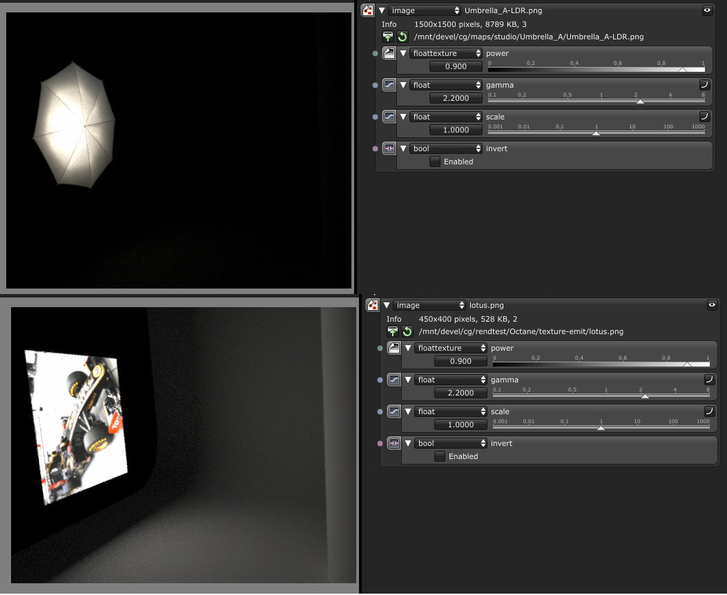

Thank you Beppe & Roeland for your time. Your test Beppe, does indeed look right.
There were two reasons for my issue:
1.) Using the wrong gamma: I used 1.0 which I thought was right for the "linear" tonemaping representation, should have used 2.2.
2.) There seem to be something wrong with the images I used for my test. See the comparison between the "studio umbrella" image, which gives no illumination of the scene and a random image snatched from the net. The second version gives a right illumination vs emitter brightness ratio.
All the other settings are the same in both cases. Has anyone an idea why that umbrella image behaves so differently? It only gives good illumination if you raise power to the point it becomes overexposed. It's a .png file which I got by tonemapping the .exr version of it, with Luminance HDR. If I use the .exr version for the emitter it gives just slightly better illumination, but still far from the second test. Tweaking image gamma doesn't help. Could such difference come from a bit more bright areas of the second image?

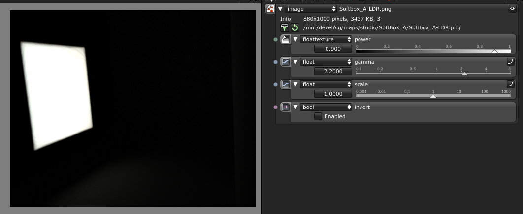

There something strange with the images I use :)
I re-tested it, this time with the softbox image (which is from the same pack the umbrella is) and it still gives almost no illumination, even if this time the image has more bright areas than the one with the formula car. Again all the emitter & tonemaping settings are the same in all three tests.
In the image node, there are three info parameters; size in pixels, size in bytes and a number. What does the number mean? In my case the formula car has 2, the others have 3.

roeland
Posts: 1826
It's not the images. For some reason Octane is always sampling the image texture at (0, 0) for calculating the illumination. This should get fixed in the next release.
