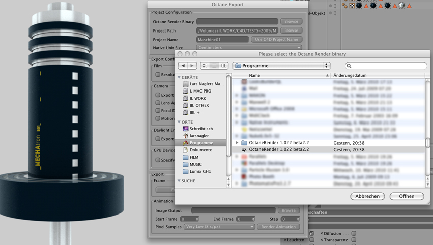

i am working with a Mac Pro, osx 10.6.3, c4d 11....
If i select the Octane Render App from the Appfolder as the Octane Render Binary, choose my Export Configurations and than click Render:
NOTHING.... .!
Why? Is the App as Binary wrong?
Thanks for your Help!
PS.: Another Question - How can i close the Exporter Window within C4D? My only Way actually is to close C4D completely.....

i was reading this yesterday..... my octane renderer is not .exe, because its a mac.....
the screenshot shows my path to the App.....

lassinger wrote:Hi,
NOTHING.... .!
This version of the exporter has the number 0.01, i.e. it's not fully functional. You can only export to an OBJ/MTL file for now. The render button doesn't work yet. I still don't have a reliable way to launch and track processes on Mac OS. When I have it, I will release 0.02 which will have a working render button, that will allow you to relink an existing .ocs file with a new OBJ/MTL file (i.e. with changed geometry).
You can always close the dialog with the ESC key.
