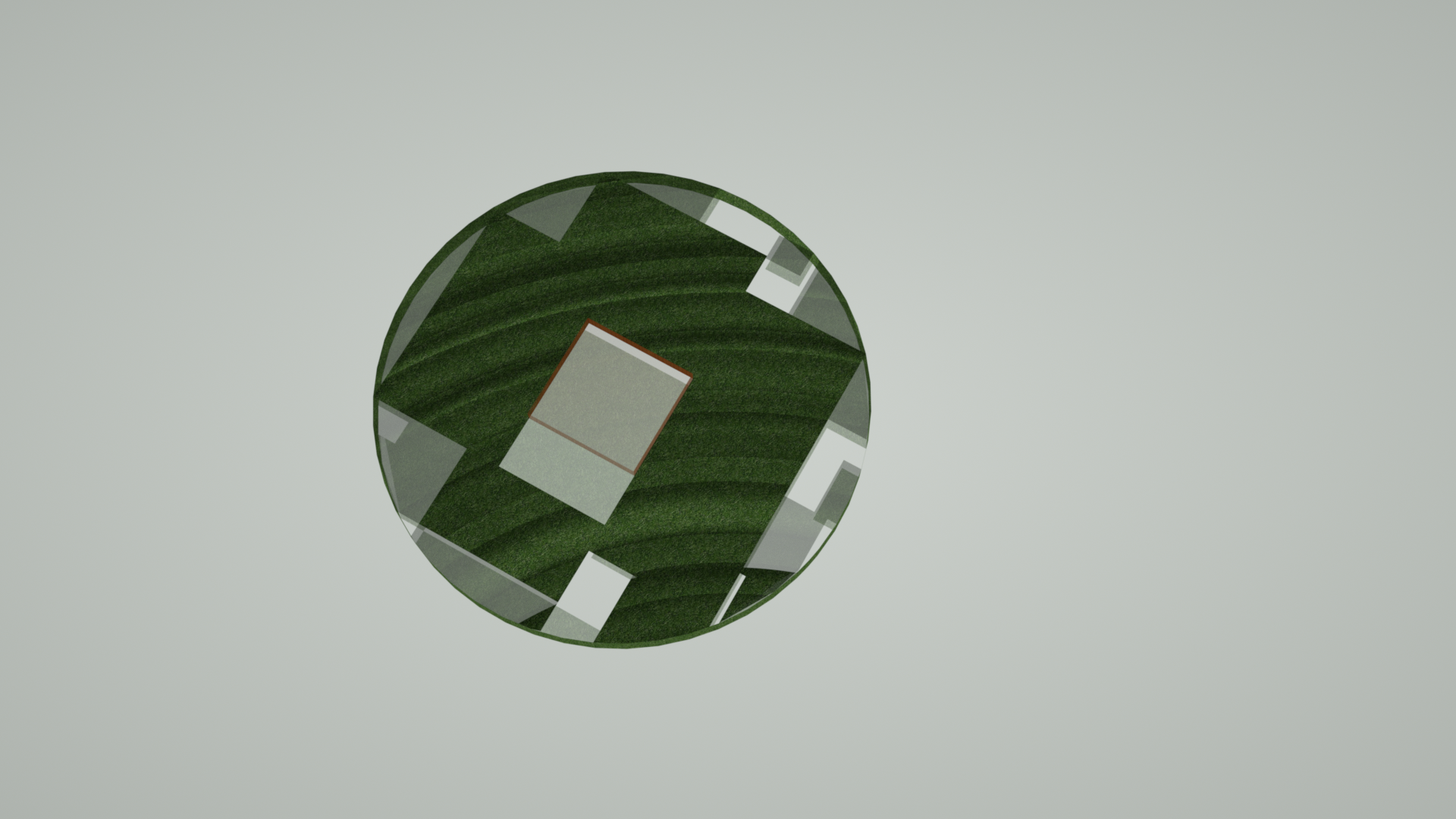

here is the image with artifacts

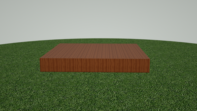

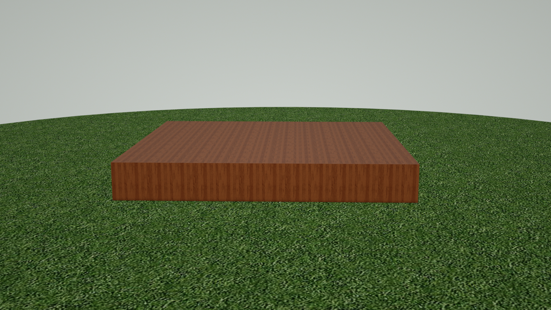

and here is zoomed in without broblem

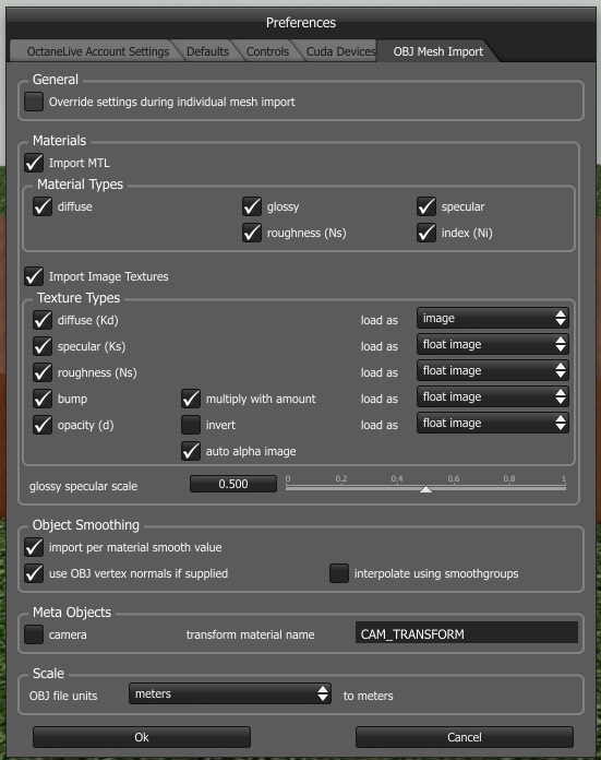

and here is the preferences options used when importing the file

This is the effect of a ray_epsilon value that is too small for the scale of the scene.
First, make sure the OBJ file is exported as 1 unit = 1 meter. If this is not the case, set the scale setting accordingly.
If your scene is imported at the correct scale and you still see these artifacts, you need to increase the ray_epsilon value.
Roeland
