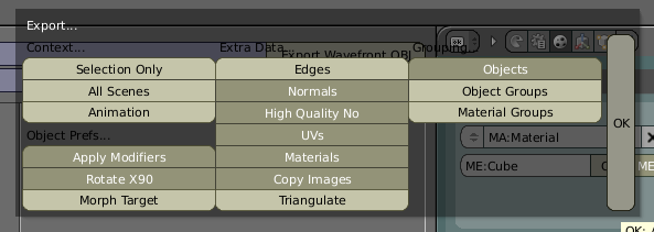

okay - may i ask then how do u get yours UV maps eksported? from blender via export script...i mapped them and they render within blender but not within octane...

My guess is that you havent put your textures and OBJ file in the same folder, or perhaps there is something wrong with your export settings.

hey,
here's the optimal settings in blender to export to OBJ.
just make sure you have UV mapped your objects that you want to add textures onto prior to exporting,
and blender will also export the diffuse maps to the OBJ file,
and these should be loaded automagically by octane when you import the OBJ.
blender will also copy the textures to the directory where you export the OBJ file.
you can examine the MTL file that gets written together with the OBJ file with a text editor like notepad,
to check what blender wrote, eg the full paths to the textures.
if no full path is given, just the texture image file eg texturefile.jpg or so,
it octane will look for it in the same directory as the OBJ and MTL file are.
