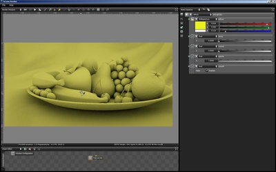

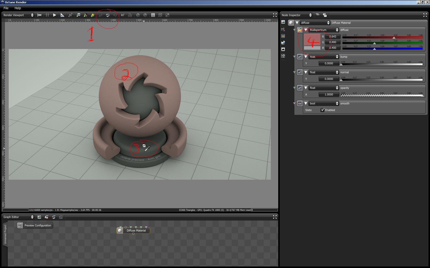

The first scene (pic 1) is the default material and lighting scene
1. I select the colour pick
2. I select this surface or not and change from default colour
3. I select this surface (nothing changes in the colour pallette)
4. the colour selector doesn't change
This fruit bowl scene is from 3dR3nder.com lighting callenge here, http://www.3drender.com/challenges/fruitbowl/index.htm
As you can see, it's been rendered in just about every 3D software known to man, so I know the object has material zones and is importable to various packages.

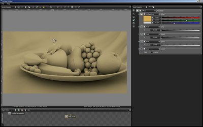

Pic 2
I load a mesh and without selecting anything I change the colour to an orange colour, it alters the overall colour of the lighting, I suppose that's the way the software works.

Actually, it seems that your whole scene uses only one single material - the light color stays the same.
In my experience - using Rhinoceros, though - this can happen when names are truncated. E.g. if you have "Basic Material 01" and "Basic Material 02" every object in the scene will have the first material with the name "Basic".
