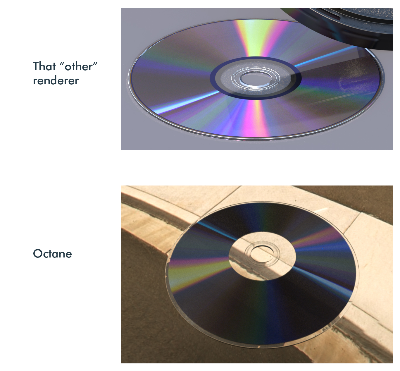

The TIF approach seems to work great except for one problem...I cannot seem to keep the CD surface from appearing dull. Please see attached image with comparison to what it should be. Clearly, the CD surface lacks brilliance, and the only way I can think of to brighten it up is to make it into an emitter. But if I understand correctly, that means the mesh must be an exclusive emitter mesh and cannot have other non-emitter textures assigned to other portions of the mesh.

The appearance of shiny objects depends a lot on the environment, so you should compare the look of the CD surface in similar scenes.
How are you rendering the CD in MR? Is it a physically based effect or a texture?

The CD surface was a digital image applied to the reflectance 0 and 90 deg. channels. Over that was placed a BDSF mirror finish.
I think you may be right about the different environments thing. But it still seems that even though I can get the intensity in the colors and all of the detail in the CD without over-exposing it, when using a Daylight environment, it seems odd that an HDR texture environment on a bright sunny day can't get close.

OK, I got a lot closer. I found that I didn't have my roughness and specular settings right. I actually got the best results by using a glossy texture for the CD surface with specular set quite low, and roughness = 0. Along with alpha, it masked correctly against the other material in the mix which was just clear plastic.
