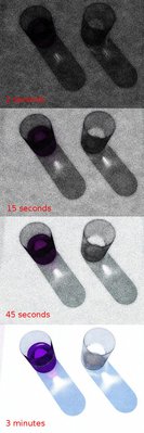

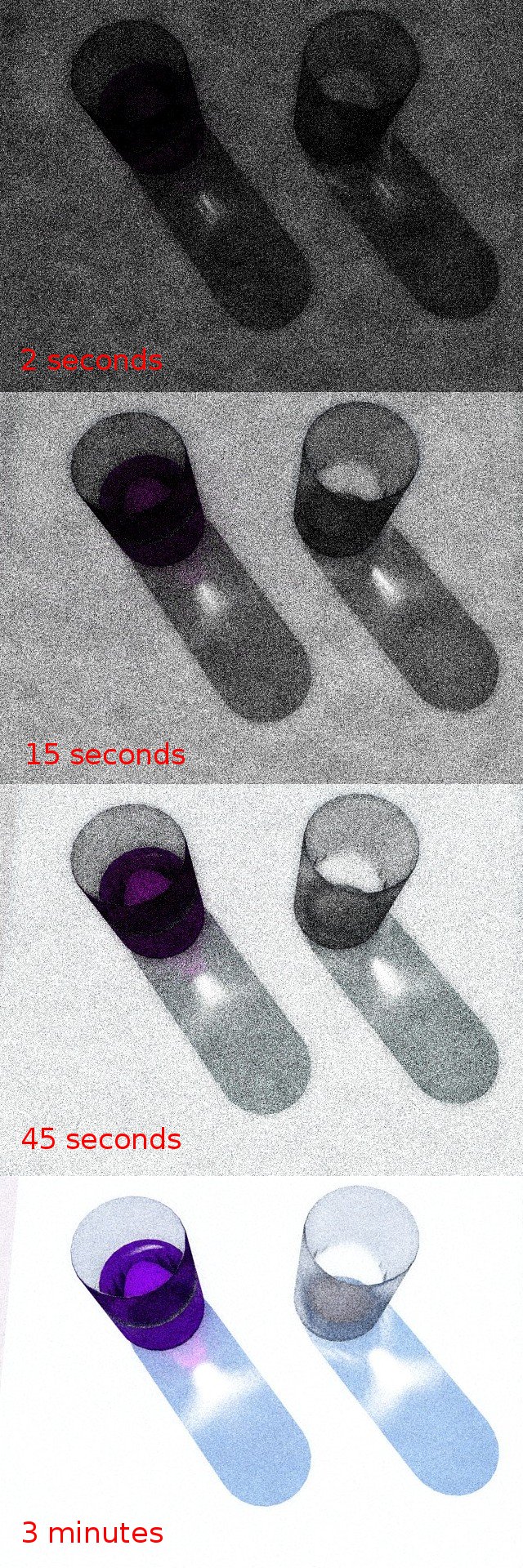

ok, a few things:
first off, your scene scale is wrong (guess 1/100 of what it was meant to be). octane units are meters, and thus your objects are only a few millimeters small.
of course caustics depends on the geometry; a hollow or cubic body for example won't create the effect you might look for.
as it lasts a while till caustics emerges, a slower card may need a good amount of minutes till it gets visible (a few hundred samples per pixel at least); and the fireflys will also vanish if enough samples were calculated.
here a quick example, roughly based on your scene (pmc, 4000 s/pix, 3min on a dual gtx 580):

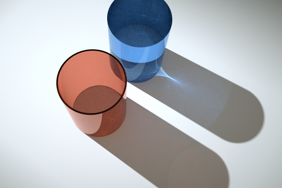

And so i will have to buy graphic card first and then play with caustics, for what i see, my current card not only refuse to calculate PMC correctly, but also doesn't do caustics.
The scale of the model is fine now (and for the sake of certainity, i have placed 3 identital scaled instances of the same object (simpliest magnifying glass) over the surface, and... it just doesn't compute.
Caustics should appear after few hundres s/px?
After over 2000 s/px i get almost perfectly evenly dark shadow with not a slightest mark of caustics.

Dear t_3, I have one question. The glass shadow should have color, but your test image the blue one and the orange one have the same shadow color, also the shadow is not transparent as real world should.

Good point.
I've noticed it too, but i thought that i'll check on the results when i will have propper hardware to compute that on my own.
My first thougth was that the reason for this is that this scene was set to match my scene, but even then, with the thin layers of glass, shadow should be barely visible, yet in octane from what i see shadow is always 100% opaque at first, and then slowly caustics are built up. The render that t_3 introduced was baking only for 3 minutes... yet...
Would the shadows eventualy be as they should or is there a special trick to do in order to get the propper shadows (and thus, propper caustics)?
EDIT
Just checked in Kerkythea. As in Octane, the shadow in the scene is opaque in beginning, but...
In KT there are two modes suppurting caustisc, PhotonMap+Caustics and this gives fairly good result, and BPT (Bidirectional Path Tracing) and both give caustics instantly (they show up as one would expect, from the beginning). I know that it is completely different engine and it's CPU, not GPU based, but caustics should look like in real world no matter what processing unit program use, and in KT i have the option to turn on the mode that does what i want, is there one on Octane?
To show how does it looks like in KT i've attached file.
As you can see, shadows are not perfect, but even with this i at least can see where all the light gone. It bends in the glass and follow to different point. In Octane it seem to vanish in large quantities so in the end one needs few hundred s/px for caustics to show up.
The 3 minute rendering i showed had 8 passes (not sure if it's equivalent to s/px, though. Probably it is.)
EDIT
