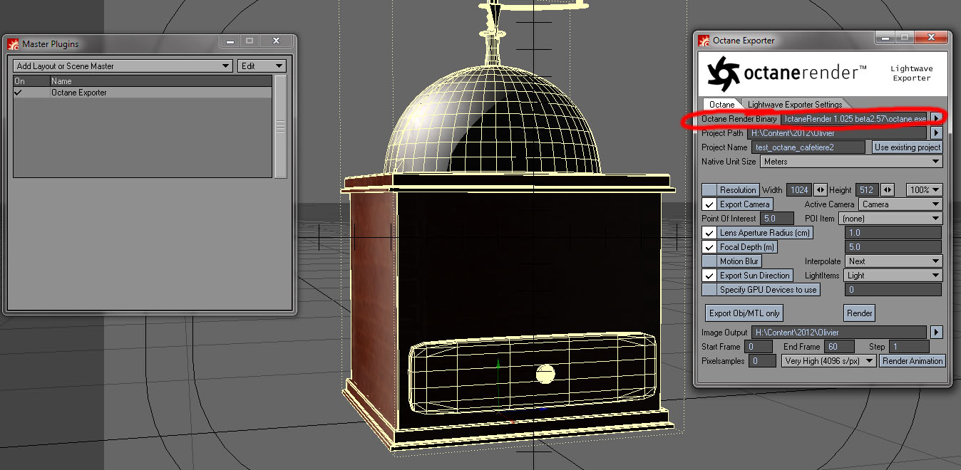

My license is activated and Octane standalone run well.
I've installed the plugins...
But when I click on "LaunchOctane" in Lightwave, nothing happend !
Idem when I click on "OctaneExportOBJ", nothing happend !
A window appear and instantly disappear.
It seems there's no communication between Lightwave and Octane.
I can open the Octane panel when i manually add it (Master Plugins -> Add Layout or Scene Master -> Octane Exporter)
But it's impossible to generate an *.ocs file.

I couldn't even get that far! I had it working with Lighwave 10 but when you launch the plugin nothing happens in 11. I notice your using 9.6 so there should be no problem. Any further help would be appriciated.oliv3d wrote:Hy, did you shown where is Octane render to your plugin ?
