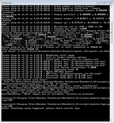

I just tried a scene that was working with 1.12 but now gives an error. Blender build 44136. I'll go and grab the latest SVN to see it that helps.

steveps3 wrote:Blender build 44136
The error is here. This Exporter is for lastest builds:
yoyoz wrote:tested with 44639 and 44651

Just tried 44639, works a treat.
oh wait, blender works a treat but Octane crashes. I suspect that it is the export that has caused it because Octane hasn't changed in quite some time. If it helps the problem even name is BEX64. There really isn't much else in the report but here it is just in case someone can spot something.

aLeXXtoR
Posts: 294
Joined: Sat Oct 29, 2011 5:38 pm
Location: Russia, St. Ptetersburg
I confirm. Octane crashes while loading scene.

I just tried the default cube and that worked fine. I will slowly work on this to see if I can find what it that is causing the problem.

I think I have the answer. It appears to happen when the object being rendered has no material. I found that one of the objects in my scene didn't have a material. I put this on its own layer and rendered just that layer and sure enough it crashed. I then gave it a material and it rendered with no problems.
