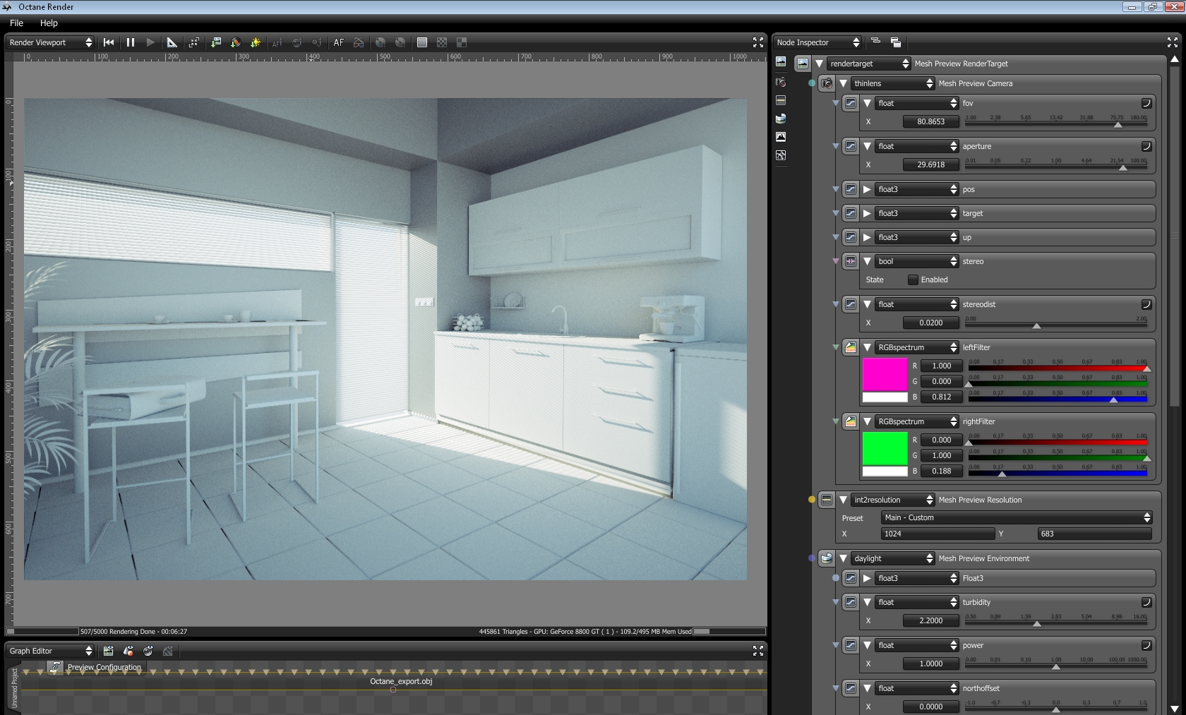

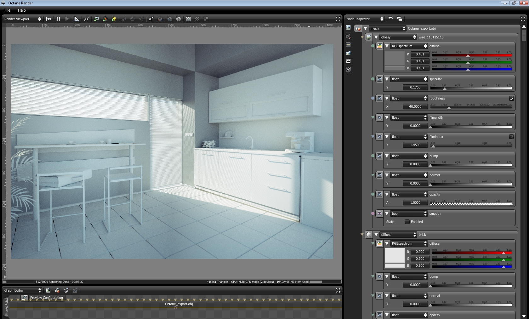

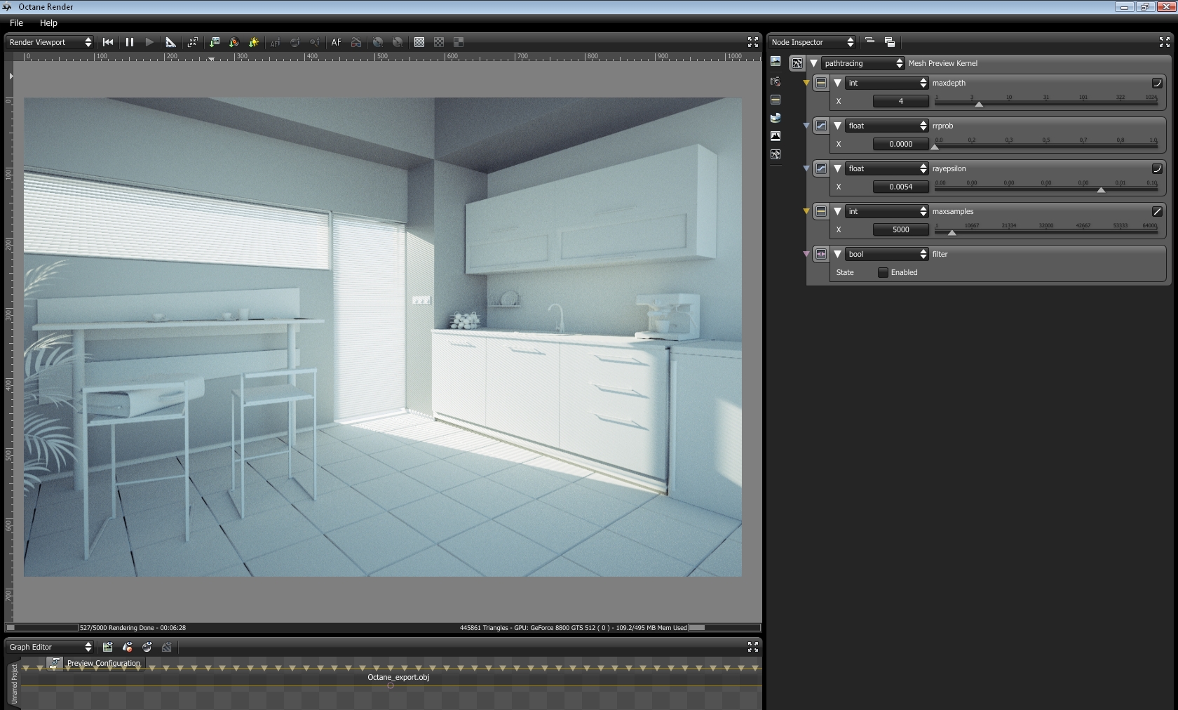

There is something weird, or I do something wrong, but seems I get higher samples with first single GPU than with both...
And what about memory usage?? It's double in multi GPU mode. I know that have to be loaded in both GPU-s.. but that way seems i have left less memory than with one GPU scenario. Also some weird line in the middle, separating both GPU calculations in multi GPU mode. Renders was done with pathtracing kernel, scene is saved in Octane beta 2.1 non multi GPU version. No material applied to any object ( uses the kilaD scipt to export ).

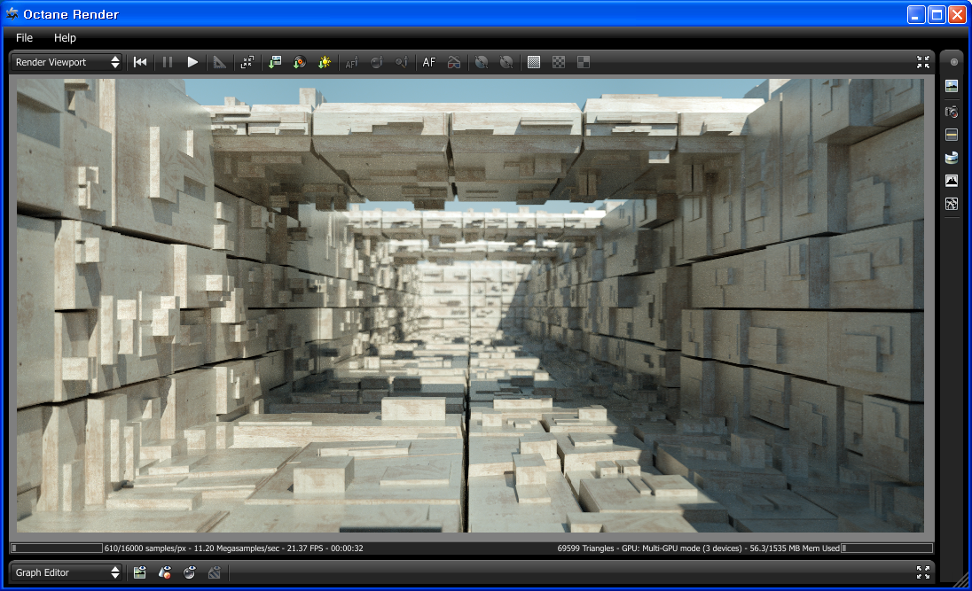

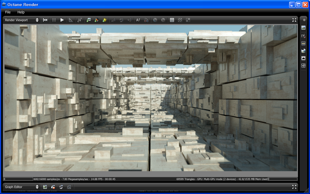

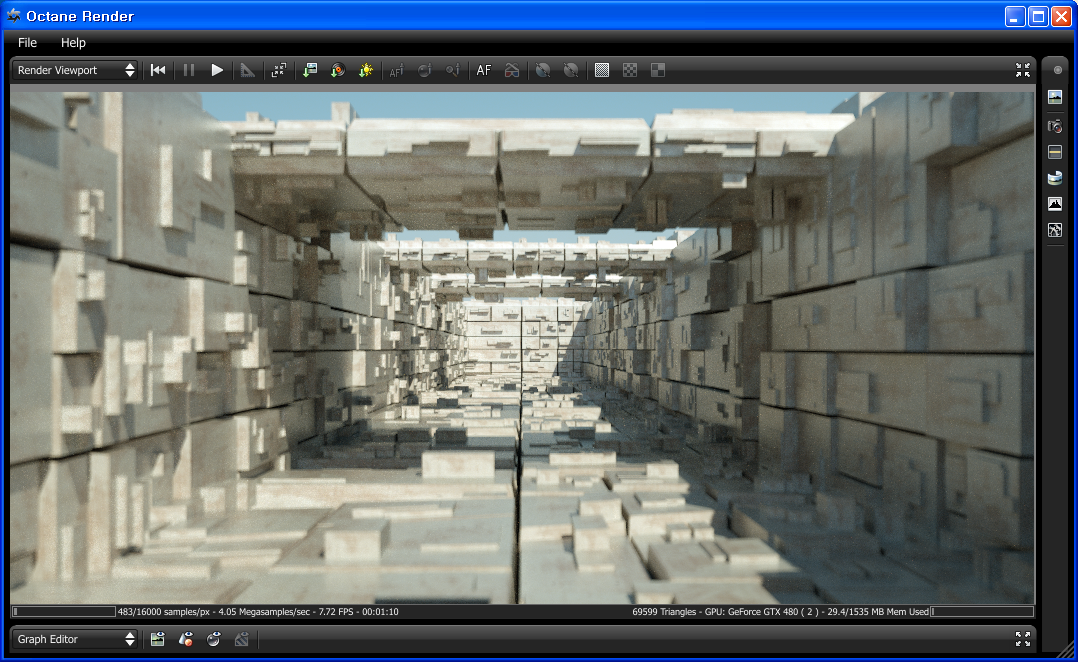

1x GTX480 = 4.05 msps : +4.05(100%), 1.00(100.0%)
2x GTX480 = 7.80 msps : +3.75(92.5%), 1.93(96.50%)
3x GTX480 = 11.20 msps : +3.40(83.9%), 2.77(92.22%)
Near perfect scalability !! :) :)
The GPU scalability was near linear, perfect.
It was really fast. Scenes were completed within 10 seconds.
And GPU selecting dialog box was working well.
