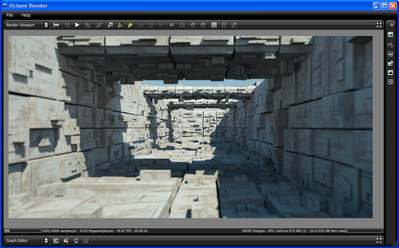

:o :o :o 24M samples/second?

you're using the directlighting integrator ?

You are right. :oops: :oops:
Anyway, it's really fast .. :)

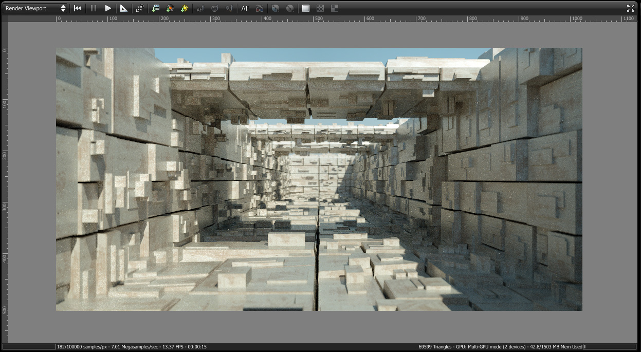

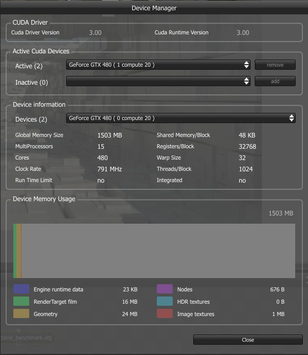

here's a first report of the working multi-gpu version. (default benchmarking scene with pathtracing)
there's still some stuff to do and the tonemapping is still not done on both,
so these numbers are not final and will go up.
with 1 GTX480 i get 3.91 MegaSamples/sec
with 2 GTX480 i get 7.01 MegaSamples/sec
so that's not double speed but 1,8x the speedup.
we should be able to get it up to 1,95+ with the tonemapping converted into parallel (currently it's serial).
still 7 megasamples/sec is awesome. image is clean after 40 seconds.
