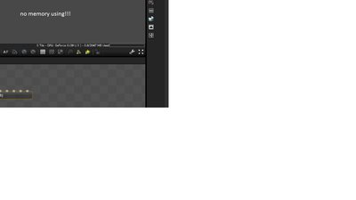

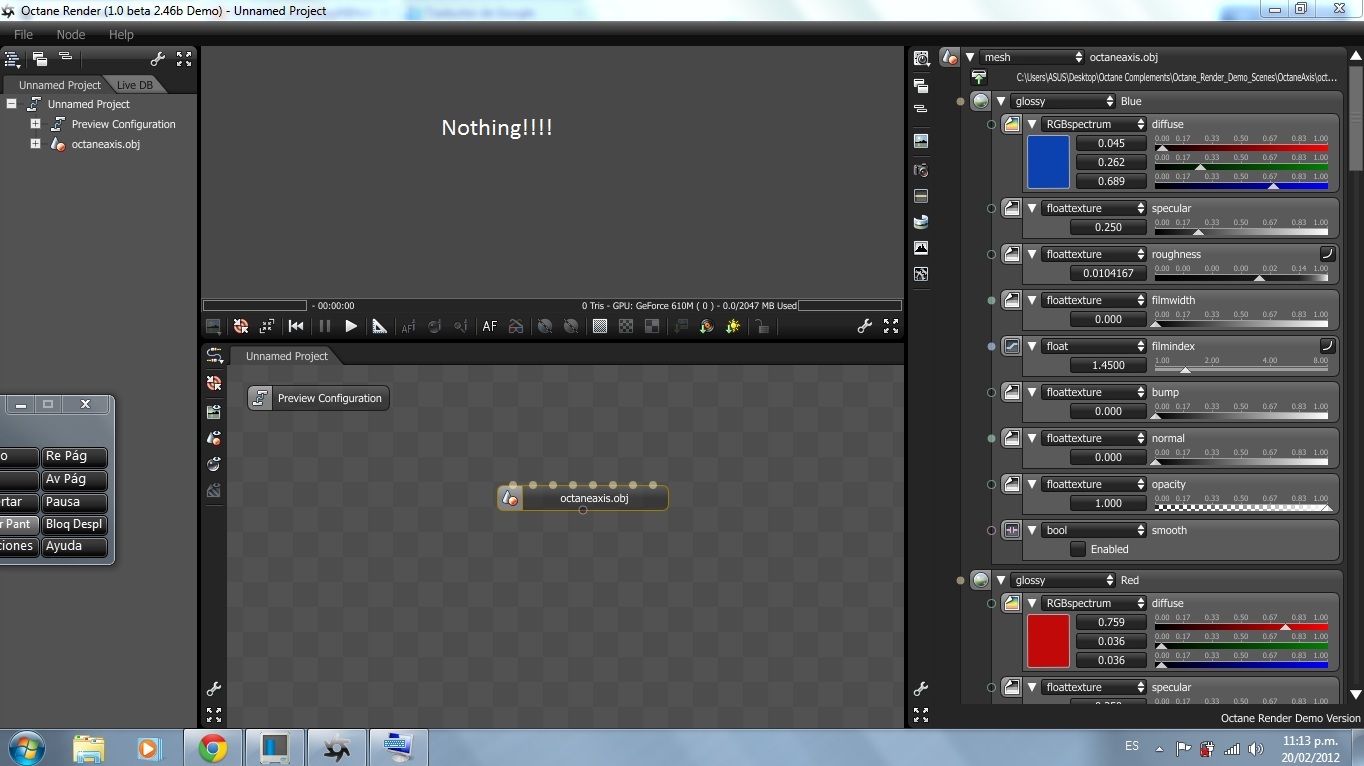

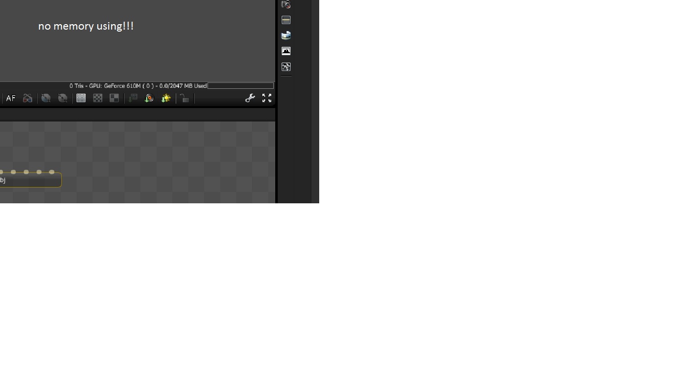

I have some problems. I bought an ASUS A53 with a 2Gb GeForce 610m, when I add a mesh and I click on it to view in the above screen I get nothing, and there not indicates that the video card is using his memory.
This happens because the program or the card are misconfigured ?, Or because the demo does not work well?, Or because the video card does not work properly with octane?

Are you connected to the internet? Octane contacts home to verify licensing.
BTW I see you have non Latin letters showing in the calculator? in the screen shot.
Make sure any paths/file names and images for Octane only use Latin characters.

The demo does not connect to anything over the network.
You should install the latest drivers from www.nvidia.com.
