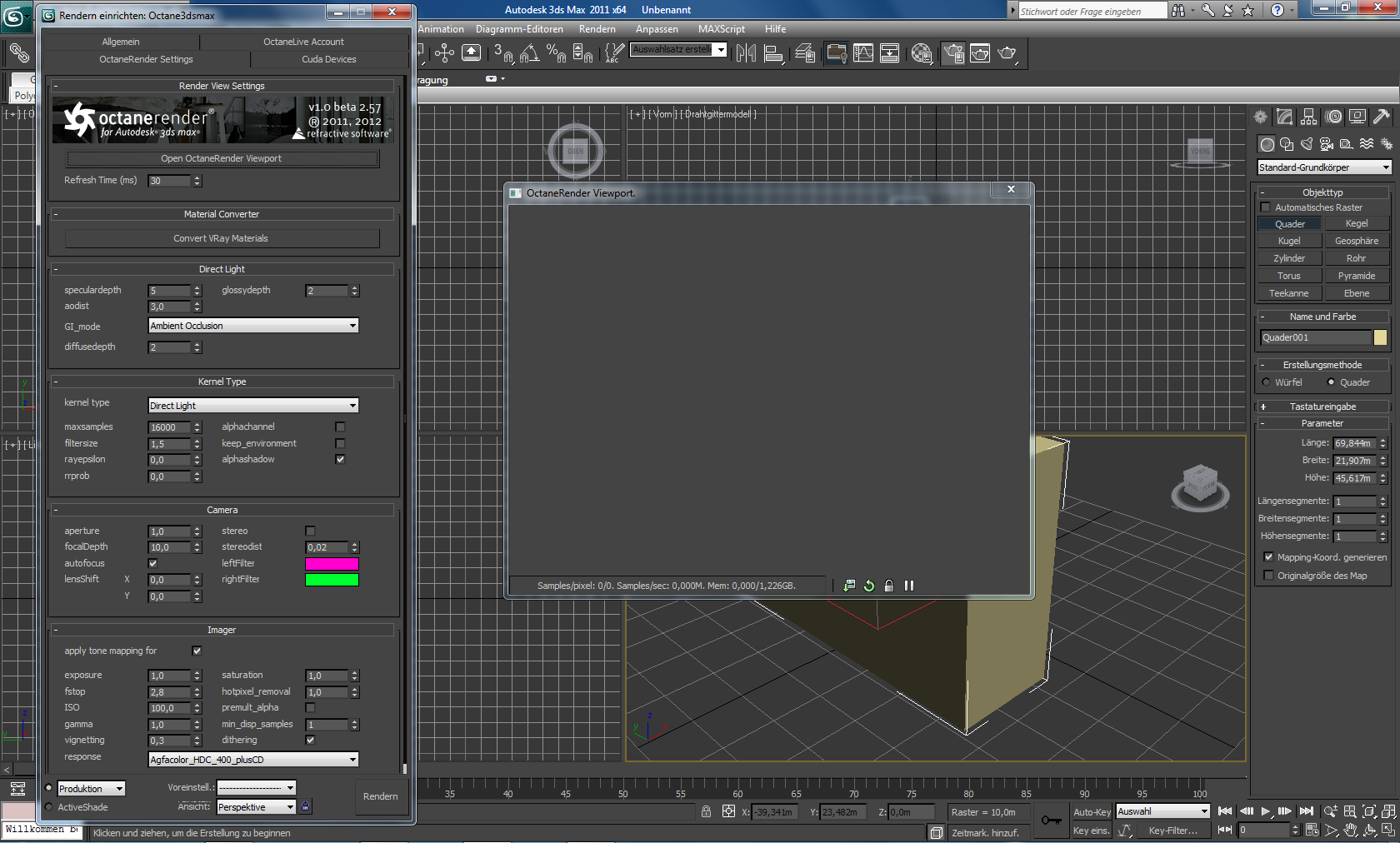

Hello Guys,
i have a problem with the octan viewport, octan will not load the szene.
look at the picture, maybe someone knows why.

Did you make this box before Octane viewport opening or after?
Have you activated your plugin and standalone licence?

i create the box before i open the viewport
yes i have activate octan standalone and the plugin

Can you share this scene?

can i start octan standalone and octan for 3ds max together?
how can i share a szene?

said wrote:can i start octan standalone and octan for 3ds max together?
No, You can't. I think that is the reason.

ah okay i will look after my current render thx for you support

allright it works thx!!!
