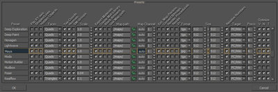

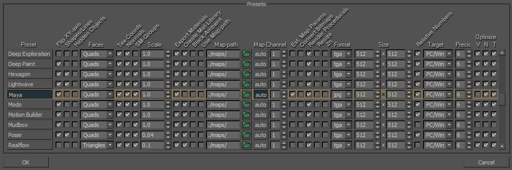

radiance
Posts: 7633
This is a shot i just got from BdB with his export settings.
I think the issue that screws up the UV maps is the 'relative numbers' option,
this should be switched off imo.
The rest should be ok in the screenshot.
Could you see if you can ameliorate this,
try to get a fully configured max scene into octane,
and then post a shot of your config for other 3ds max users ?
Radiance
[gk]
Posts: 574
Joined: Sat Jan 16, 2010 12:48 pm
Location: Denmark
The following settings provides a somewhat optimal solution in my case here.
I made a teapot that is 2meters long. So the floor area is a good normal 1:1 size for a car, a group of people or anything down that scale world wize.
Note scale is set to 0.1 ( this size give you a loaded mesh in octane that you only need to zoom out from 2 meters or so and then the pan, rotate controls are nicely fresh )
I noticed the viewport controls scales with the model, so if we make a super tiny model the controls are very sensitive.
And Output relative numbers are disabled ( this feature screw the uv's up on the plane however not on the teapot )
uvs in max
uvs in octane
