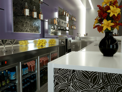

by the way gabriele
do you using some photographic lighting technique for this bar shoot?
I mean you put some plane light behind the camera etc or just the lighting from lamp?
thanks

this rig is a little bit complextonycho wrote:I Lovveeee it
by the way gabriele
thanks
I have three planes behind the camera 5000 - 5500 - 6500 kelvin
It's important (in a 3d or real scene) to have lights with different colors from slight orange to slight cyan (mixed warm and cool). This is not a fixed rule. If you have a car you have to use only cool lights for example. If you have a colored interior you can mix lights. Take a look at any movie scene and understand how is illuminated. Sometime some lights are forced (blue or orange for example)
On the ceiling I put a planar light (hided)
The ceiling got lights in the caves
There are lights behind the panels with bottles that simulates fluorescent lights (forced 8500 k)
One HDR image in the environment slot.
In every shot I calibrated the lights differently
I love real photography, it can help you on how illuminate a subject.

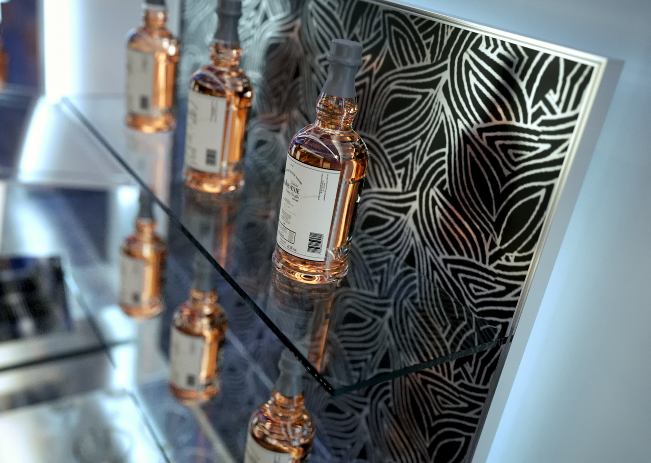

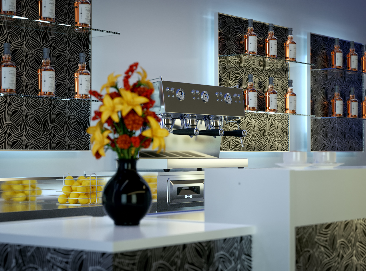

please do something for me !
please rerender the 3rd picture with different format... 2:1 ( my personal favourite ) like 2000X1000 and upload it on competition topic...
maybe Im little weird but 4:3 or similar proportions feels old
other than that top notch work... and 3rd render just kicked my ass..

I meant 4th image
