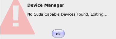

Hi i actually downloaded the Demo version and also installed the: devdriver_3.0_winvista-win7_64_197.13_general
driver.
but when i start Octane i get a error Message.
can you please give me a tip how solve it.

the FX 5500 is based on the 7000 series, and is not cuda capable, it's too old i'm afraid...

And is the Geforce 8800 GTX compatible ??
Chris
Posts: 439
Joined: Thu Jan 14, 2010 5:01 pm
Location: Norway
Yes i think i t is.

You can find out which cards are CUDA capable on this site:
http://www.nvidia.com/object/cuda_gpus.html
BTW, there are a few cards that are CUDA capable that are not on the list.
