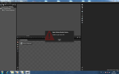

When i try to open Octane Render Project File - "Open Octane Render Scene.....Unable to open Scene File"

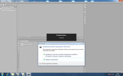

When i try to open mesh (obj file) -"Compilling Mesh....Voxelizing" after that windows error Octane.exe - close programm.
i can't to open demo obj or octane project files

Hi sergej,
make sure that there are no Cyrillic characters in your directories or your files or your materials.
octane can´t handle that.
