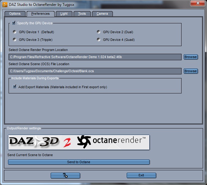

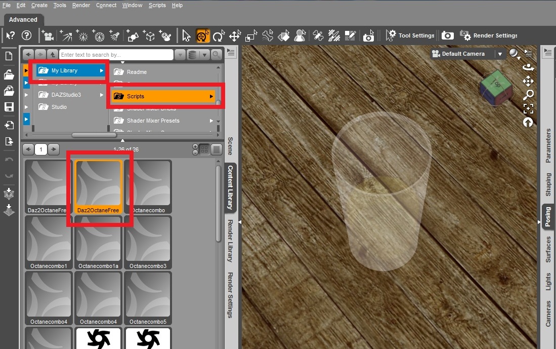

Setup your scene in DS. Locate the Daz2Octane in your scripts list. Launch D2O, it will use the current default view as the render view for Octane.
On the Options tab set "Maximum number of samples per pixel", Strength of DOF effect
On the preference tab, set the location of Octane.exe and the path to a Blank.ocs file for your current version of Octane renderer (This will change in the future as the final version of OCS file is adopted)
On the lights tab select "Add Sun to scene" to add a sunlight rather than the default light.
Select "Send to Octane to transfer your scene to Octane and start rendering with the parameters on the options tab.

Try a simple experiment and double click the file in the script folder without Daz launched or even better drag the script from an explorer window and drop it on your scene.teecee2107 wrote:Sorry, Tugpsx, the plugin doesn't seem to work for me.
When I start the script, I receive a message saying :
An error occured while reading the file, see the log file for more details
So I checked the log file, but the only thing I saw was :
Executing DAZ Script file: C:/Program Files/DAZ 3D/DAZStudio3/scripts/Daz2OctaneFree.dse
Failed to load script file!
I can send you the complete log file in case you need it.
I'm using DazStudio 3.0.1.120 Advanced Edition (64-bits) on windows 7.
I'm certainly doing something wrong, but I can't figure what it is.
Thanks for your help
