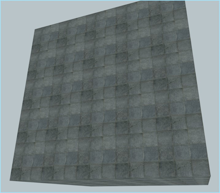

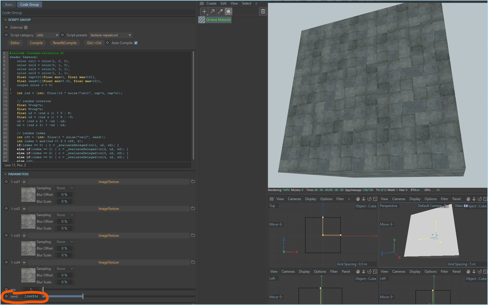

OSL tilers are very great things to make small texture tiles not repeative but unfortunately seed and randomizing doesn't work in their code.
Only way is to make different rotation in transform nodes for individual images ( 0, 90, 180, 270 degree ) - but without randomizing them.
Original texture :

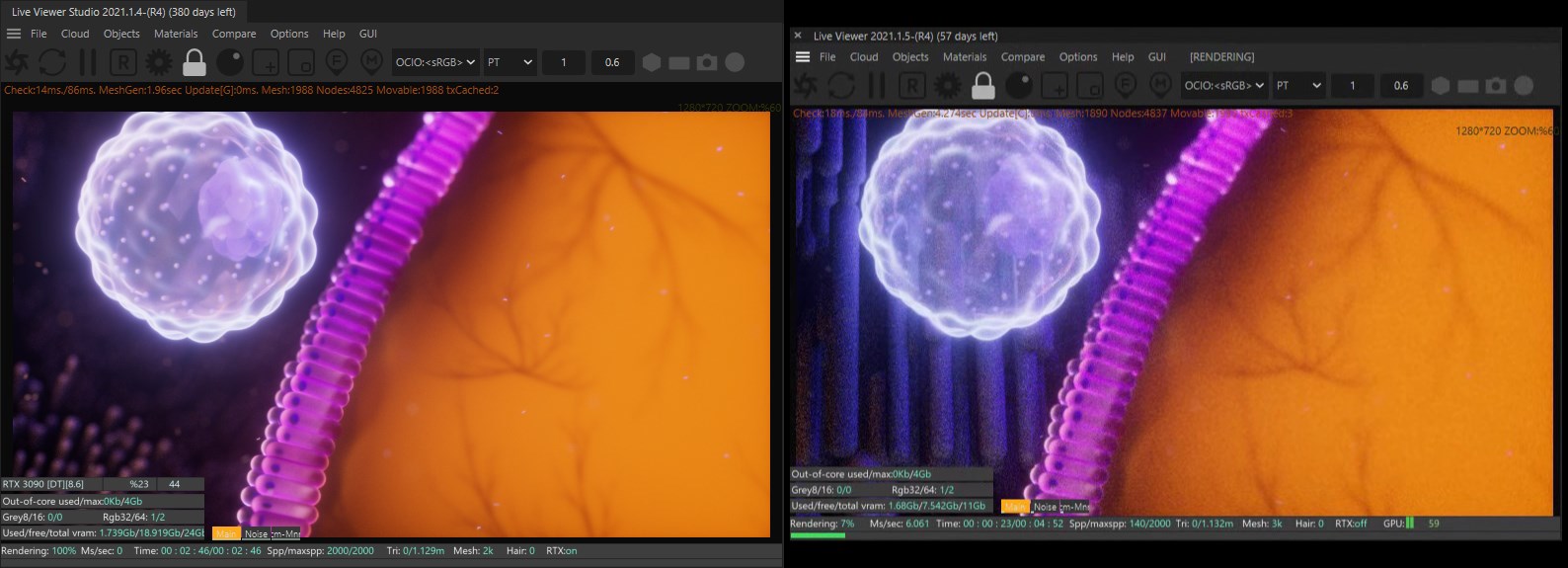

I am having an issue with the Scatter object after upgrading from 2021.1.4-(R4) to 2021.1.5-(R4)
I have a .abc animation inside an Octane Scatter object but the render looks very different. Cinema 4D R26.0.14
I saw in the release notes "Fix: orientation problems with scatter object" What exactly was the fix and how can I fix this issue? Thank you!!!
