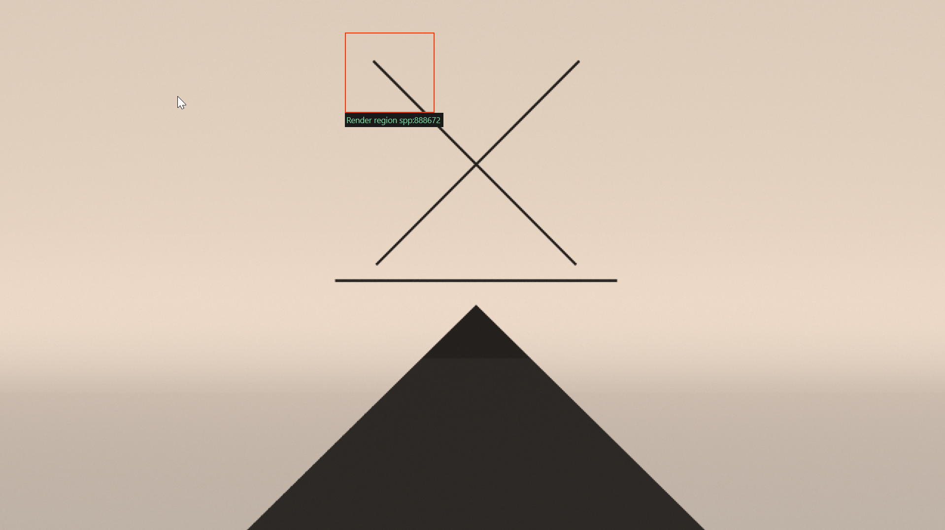

Hello! I'm having scaling issues with Octane for the first time ever, and it happened right when I installed this 2019.1.1 version + C4D R21. It seems like it's unable to work with windows 150% scaling of my 4K monitor. Even the buttons seem pixelated. Windows is updated, Nvidia drivers too (I tried both Studio and Game-ready drivers). Is there something I'm missing? I'm sorry, I've been looking everywhere before posting here.

bloomis2 wrote:Hello! I'm having scaling issues with Octane for the first time ever, and it happened right when I installed this 2019.1.1 version + C4D R21. It seems like it's unable to work with windows 150% scaling of my 4K monitor. Even the buttons seem pixelated. Windows is updated, Nvidia drivers too (I tried both Studio and Game-ready drivers). Is there something I'm missing? I'm sorry, I've been looking everywhere before posting here.
Sorry! What you do? Are you scaling C4D from nvidia control panel? We don't have any highDPI support for 4k monitors

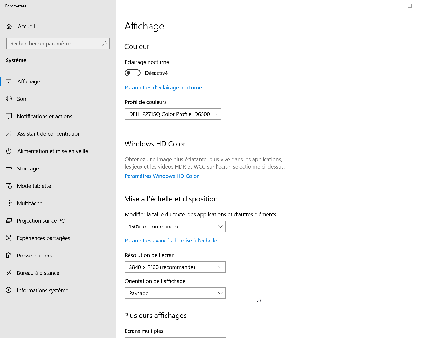

I'm sorry, English isn't my first language :) I'm not scaling anything, or touching any parameter in Nvidia or C4D. I just have windows display settings scaling the resolution at 150%, so that everything isn't super small on my computer. I had this for years with no troubles, even with Octane. But then with R21 and this octane version, I get this issue. I know you don't have any High DPI version of Octane, and it didn't matter until this happened. If it was only the UI it wouldn't matter. But the image is affected too.

bloomis2 wrote:I'm sorry, English isn't my first language :) I'm not scaling anything, or touching any parameter in Nvidia or C4D. I just have windows display settings scaling the resolution at 150%, so that everything isn't super small on my computer. I had this for years with no troubles, even with Octane. But then with R21 and this octane version, I get this issue. I know you don't have any High DPI version of Octane, and it didn't matter until this happened. If it was only the UI it wouldn't matter. But the image is affected too.
So it's not an issue with related Octane. You need a customizable Octane gui/fonts for 4K

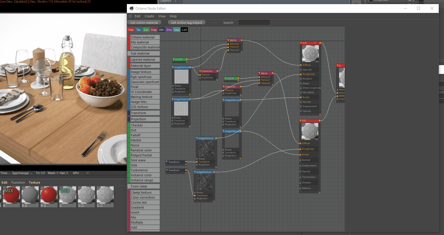

I have been reshading some assets with some better practices and I noticed this bug that persits since V2. It's not critical but I let you know just in case.
So here you go:
A MIX shader with 2 materials that use same textures for diffuse, bump, etc (all duplicated). I decided to unify the textures in order to make it more efficient. Here is when this small bug takes place:
The renoded shader doesn't recognize the new node in it's preview window - although the final MIX preview works fine and the Live view renders just fine. To fix it you must create a new node and relink both materials inputs.
Like I said before, it's not critical but it comes a long way it persists - even though I don't use MIX shaders anymore ,with some exceptions.
Thanks for the great work!

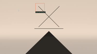

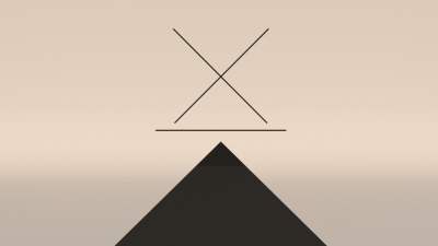

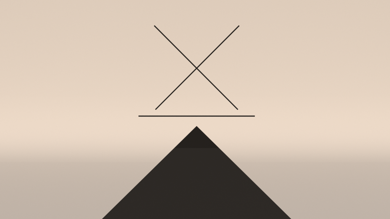

No, I'm not talking about the gui / fonts. I'm talking about the image in the live viewer. It is pixelated, even when the resolution is locked.
Pixelated live viewer
It should be like this : (image rendered)
Clean render
Clean render
The image is 1280x720. I never had this issue before, in R20, so maybe it is due to the new C4D 4K resolution. There is a conflict there.

I think I had a conversation with Ahmet a few years ago about a related issue. As I recall, he told me it is an internal limitation with the way C4D thinks about materials and their sub-components. Essentially, C4D assumes each node in the shader only has one "true" parent material and makes some assumptions and shortcuts based on that. While you can connect nodes to multiple "parent" materials, it's often only the first material that will be properly updated when a shared child node is changed. Things generally still render properly, but you may not get the feedback you expect without forcing a refresh.
Maybe once Octane's and C4D's new node based shaders are more tightly integrated, this issue can be resolved.
