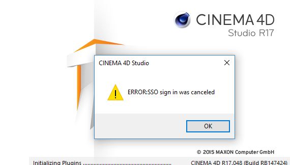

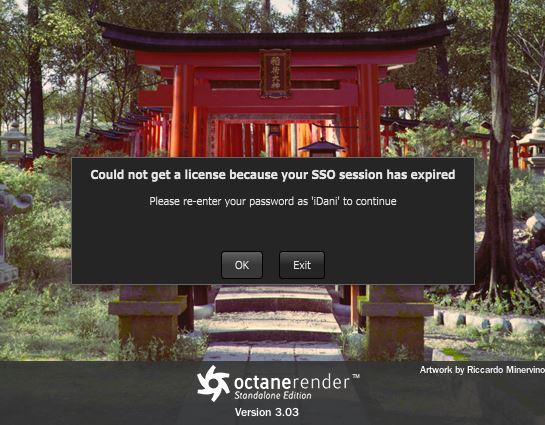

Hi Aokter,
i have updated the Standalone and the Plugin to the last Version. But now i cant start Octane in Cinema or in Standalone.
SSO session is expired. (See Attachements)
I have Win 10 and Cinema R17.
In the "Authentication issues" Forum i have nothing found.
Posts: 16066
Location: Türkiye
iDani wrote:Hi Aokter,
I think you need to deactivate with 2.x versions before run V3. It's on older authentication system.
Do it from plugin and SA and try V3. And first check it working by Standalone.
iDani
Posts: 35
Joined: Sun Jun 07, 2015 9:24 am
Location: Germany
Thanks Aokter,
i have reinstalled the V2 SA and Plugin, i have logged in and than i have deacivated. Then i start V3 SA and if i try to log in, the window comes over and over.
I used V3 since its releasd. No problems. But today nothing is working. I have offline activation switched on, maybe this is wrong? But i cant untick this.
Sorry, i think it is nothing with the Plugin.
Posts: 16066
Location: Türkiye
iDani wrote:Thanks Aokter,
Hmm maybe something is different on latest SSO system. You should able to deactivate from license page but you'll loose one ticked from manual deactivation. We can ask to Mojave for this.
iDani
Posts: 35
Location: Germany
I have also deactivated from the license page and lost one ticked. But i cant login, SA ask me for the password, if i hit enter SA is asking me again.
Posts: 16066
Location: Türkiye
iDani wrote:I have also deactivated from the license page and lost one ticked. But i cant login, SA ask me for the password, if i hit enter SA is asking me again.
Perfect. This is an issue which is out of my control. I'll point the issue to Mojave.
