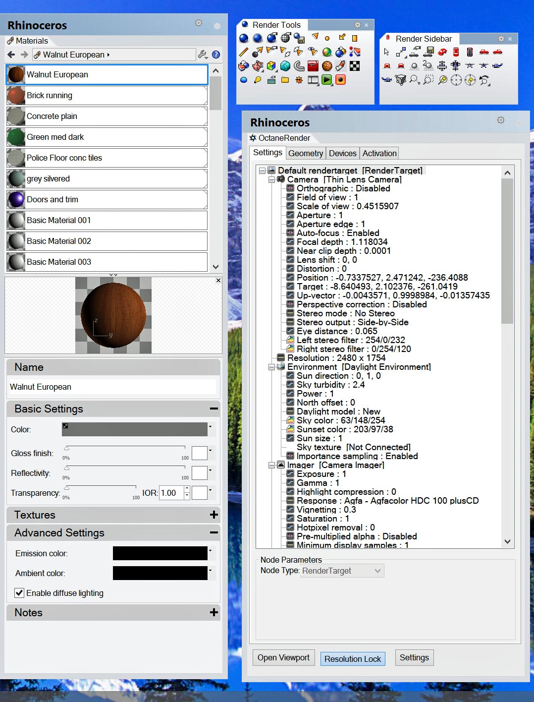

Now in build 26 Almost all of the editing choices in the 'materials' window have vanished. Scale, for instance, along with most anything else. I was having trouble changing color but now it seems I can't change much of anything.
any clues?
(edit) Sorry, I just discovered that it is only the materials that were there before the new build ... new materials from the online db come in with their editing tools.

But, the problem is that my materials are still there but they have been converted to basic materials .. I can only change color, glossiness and transparency.
The basic problem may be one of two things. I tried using VisualARQ (a Rhino plugin) which did not work well at all. And then I rebuilt the model using MoI and then brought it into Rhino for rendering. Either one of those programs may have stripped the complexity of the materials I downloaded from the Octane materials odb.

Here is a screen shot of the problem ... this material was originally downloaded from your online db. It came with a full edit menu like 'scale' and all the rest ... but now it seems to be recognized as a 'basic' material and can't be edited except with the few choices in the screen shot.

I could not find Walnut European in the LiveDb. Are you sure you downloaded it from there? What category is it under?
