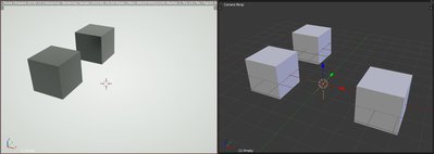

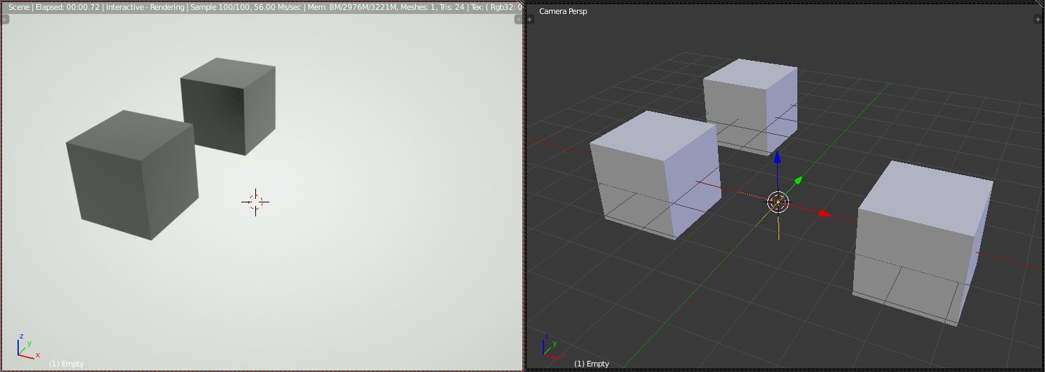

Hi
Is this a bug?
1) Add a mirror modifier to an object.
2) ALT-D to copy it with shared object data.
3) Remove the mirror modifier from the second (copied) object.
The effect is on the print screen attached below. While in 3D view the behaviour is correct, Octane seems to mess things up.
Changing the mesh type from global to scatter only makes both objects appear to be mirrored.
This occurs both during live viewport rendering and final F12 rendering.
Please tell me if this is only my mistake. Cheers,
Szymon
