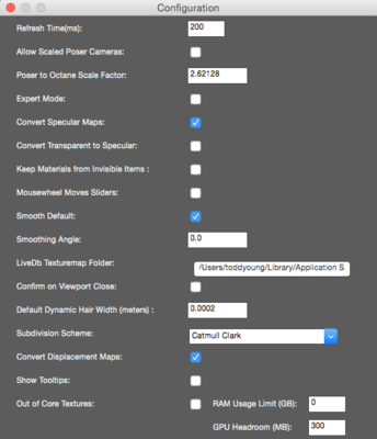

Also, can you pls post a screenshot of your plugin Configuration screen (then I can try your exact settings).

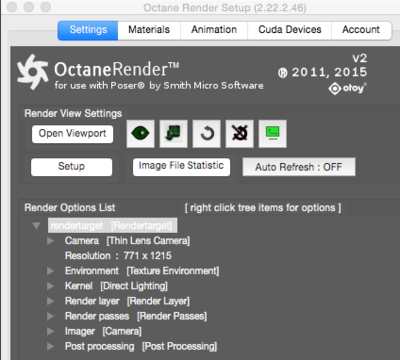

Let me know if the screenshot is not what you needed.

Can you click the "Setup" button and send a screenshot of the resulting Configuration screen pls.Let me know if the screenshot is not what you needed.

That is the same as mine - so that's not the issue.Here is a screenshot of my configuration.
Thanks. Perhaps a model you use frequently has a material name with special characters which crashes Poser on OSX, or some other similar issue.I'll continue to see what figures/objects are loaded when the crash happens.
