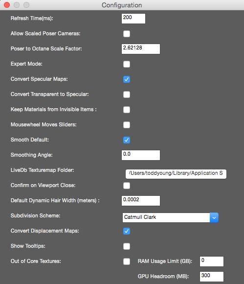

Also, can you pls post a screenshot of your plugin Configuration screen (then I can try your exact settings).

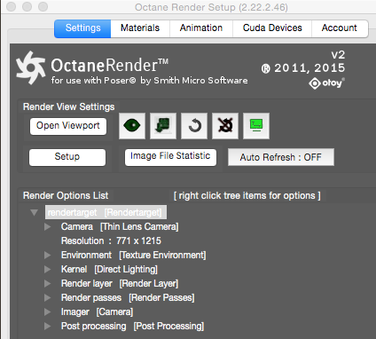

Let me know if the screenshot is not what you needed.
I'll try some of the previous versions too and see if Poser still crashes. Seems like it's inconsistent. Sometimes it happens, other times it does not. I wonder if it has to do with the objects I have in the scene.
Can you click the "Setup" button and send a screenshot of the resulting Configuration screen pls.

Here is a screenshot of my configuration.
I'll continue to see what figures/objects are loaded when the crash happens.
That is the same as mine - so that's not the issue.
