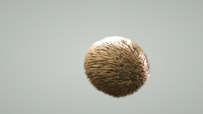

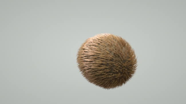

BorisGoreta
Posts: 1421
Joined: Fri Dec 07, 2012 6:45 pm
In this scene just activating motion blur ( to photoreal ) changes appearence of fibers dramatically, especially in the glossy component.
