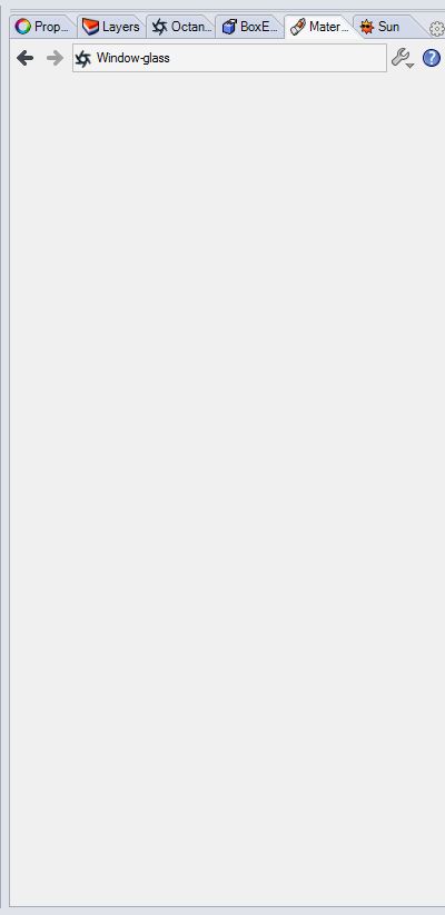

I have found an issue.
The materials tab gets empty when I assign a specular material to any geometry. Not sure if this happens every time the assignment is taking place, but definitely only with specular material. Usually it happen very often. At least once per session.
After the assignment the material tab/window looks like this - see attachment.
Rendering and everything works fine. The only way to make it normal again is to restart rhino.
If I have another rhino instance opened in the same time, then in it material tab works and looks fine.
Now to work with materials after this bug I have to open floating preview of selected material (which works fine) and double click it to open new window with only this material to edit. This window has exclusive focus, so it has to be closed to do anything else in rhino.
Any ideas?

Hey :)
Here it is - select material and press "escape" - everything in materials tab disappears.
Regards.
Mac

Hi Mac - I cannot reproduce this error. However it sounds like it could be related to the bug where Rhino locks up when switching from the docked Material tab to the OctaneRender tab. When you undock the Materials tab - can you edit the Octane material in the undocked window? Can you edit Rhino materials after this occurs?

Hi paul,
I docked and undocked material tab and it never gave me any issues.
But after pressing escape (while material selected and material tab focused) the content of material tab disappears, no matter if docked or not, and neither rhino nor octane material could be edited.
Regards,
Mac
Hi Mac. Which SR of Rhino are you on? Also, does resetting your Rhino UI (through the Rhino Options->Toolbars->Restore Defaults) fix the problem?
