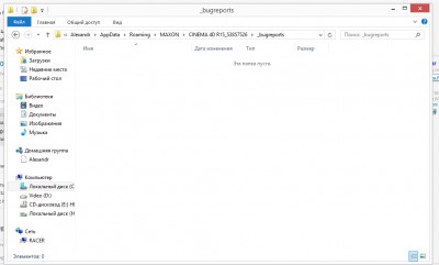

can you send me bugreport.zip? also make a tryout to work. Put oct.dat from R14 prefs folder to R15's
Folder is empty!
Folder is empty!
i sended a pm. Also i forget that try firewall setting, and be sure c4d and plugin is not blocked
