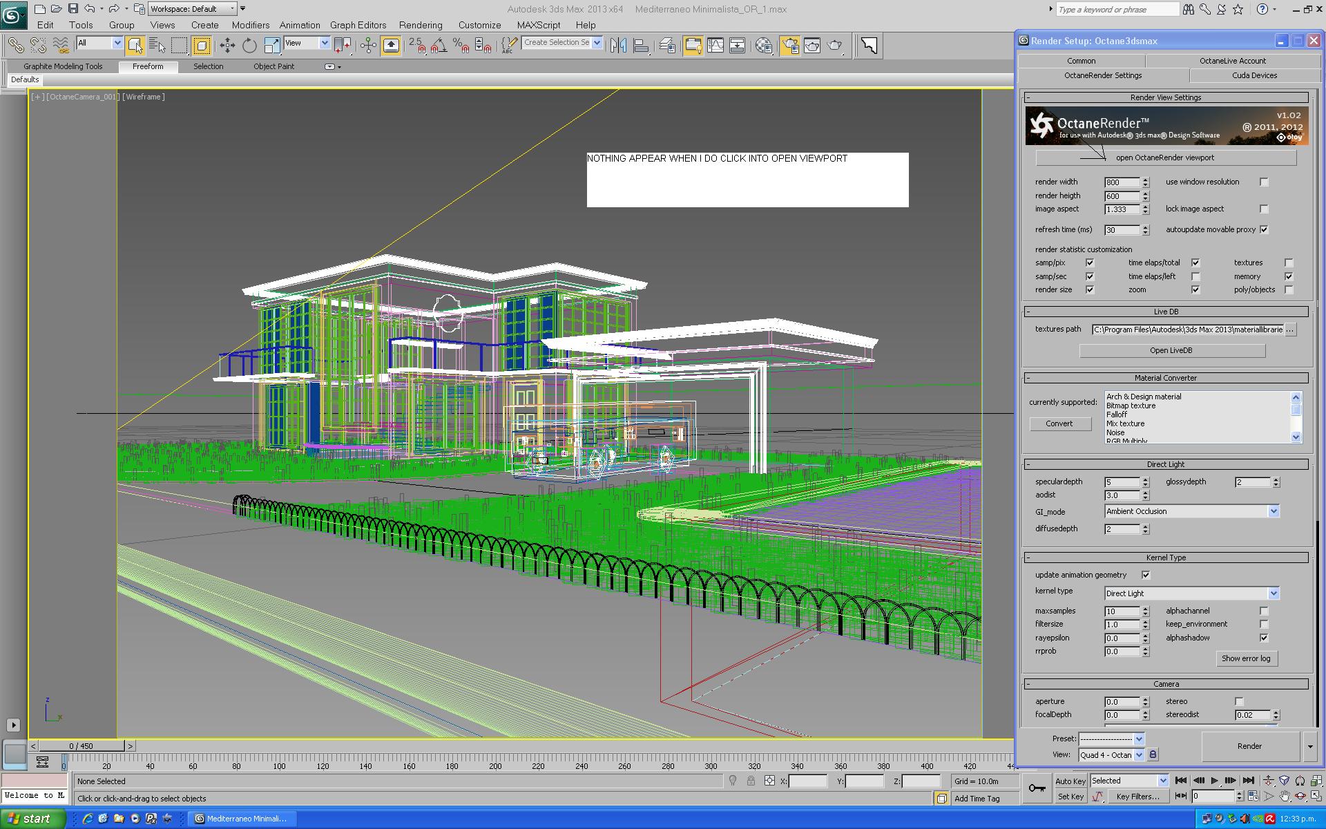

hi karba again i can't open the scene, viewport don't open, i don't know why, i think been done 2 images the last night and today i can't open it
why ?
Karba
Posts: 2300
merid888 wrote:hi karba again i can't open the scene, viewport don't open, i don't know why, i think been done 2 images the last night and today i can't open it
why ?
You scene contains a plane with zero width. Octane doesn't like it.
