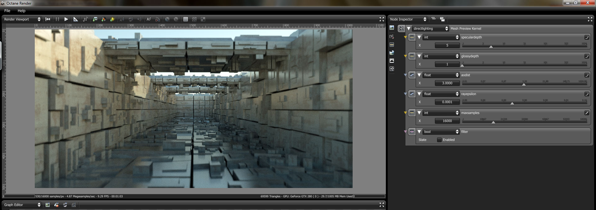

Ah, got it to work.
My GTS 250 512 mb averages around 2.28 Mpx.
System specs are I7 920 OCed to 4.031 Ghz, 6 GB DDR3 1536 mhz and GTS 250 from Leadtek, has around 5% OC from factory. it's an OC version.

good, but that is directlighting speedFlorinmocanu wrote: My GTS 250 512 mb averages around 2.28 Mpx.

Actually, it did just 0.58 Mpx.
But, why is path-tracing emphasized on? Gives more accurate/faster results? Or what?
