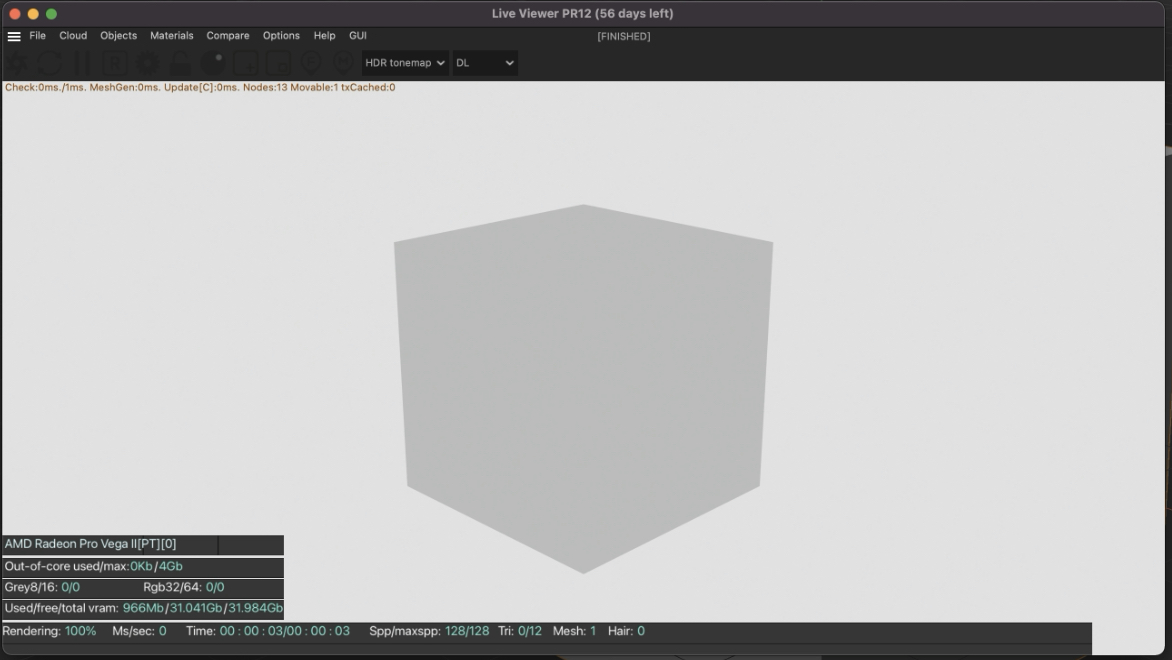

About the new c4doctaneX PR12 version for Enterprise license, there is an issue with the darker interface in R25, so the old icons are not good:
to solve the issue, please replace the res folder in R25/plugins/C4D-OctaneX-Enterprise-PR12/ directory with the following one:
res_for_PR12_R25.zip
(19.36 MiB) Downloaded 441 times
Afrer restart, Live View should look like this:
Happy Mac GPU rendering,
ciao

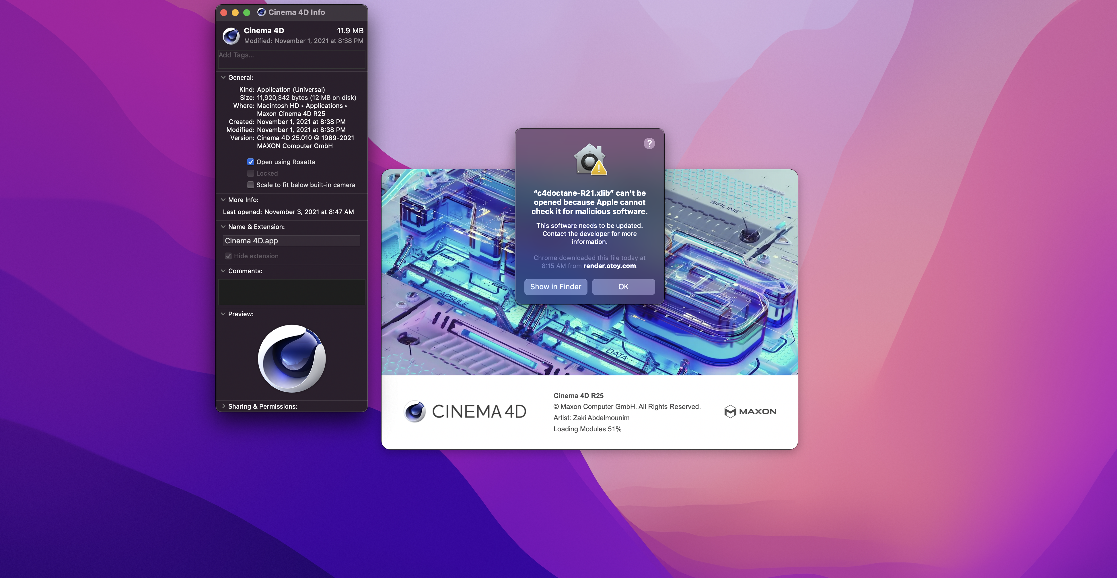

I can't get Octane X PR12 to open getting tons of errors and crashes with rosetta enabled. Without rosetta it doesn't show at all.
Using M1 Max.

leonthegod wrote:I can't get Octane X PR12 to open getting tons of errors and crashes with rosetta enabled. Without rosetta it doesn't show at all.
Using M1 Max.
Do you have 25.015?
Using M1 Max.
You need to allow the c4doctane plugin and library in System Preferences/Security and Privacy panel, and restart C4D a couple of times.
Using M1 Max.
Do you have 25.015?
Yes I just upgraded to the latest 25.015 and still crashing.. I allowed the c4doctane-R25.xlib in security preferences. Am I supposed to be using it in rosetta mode?
