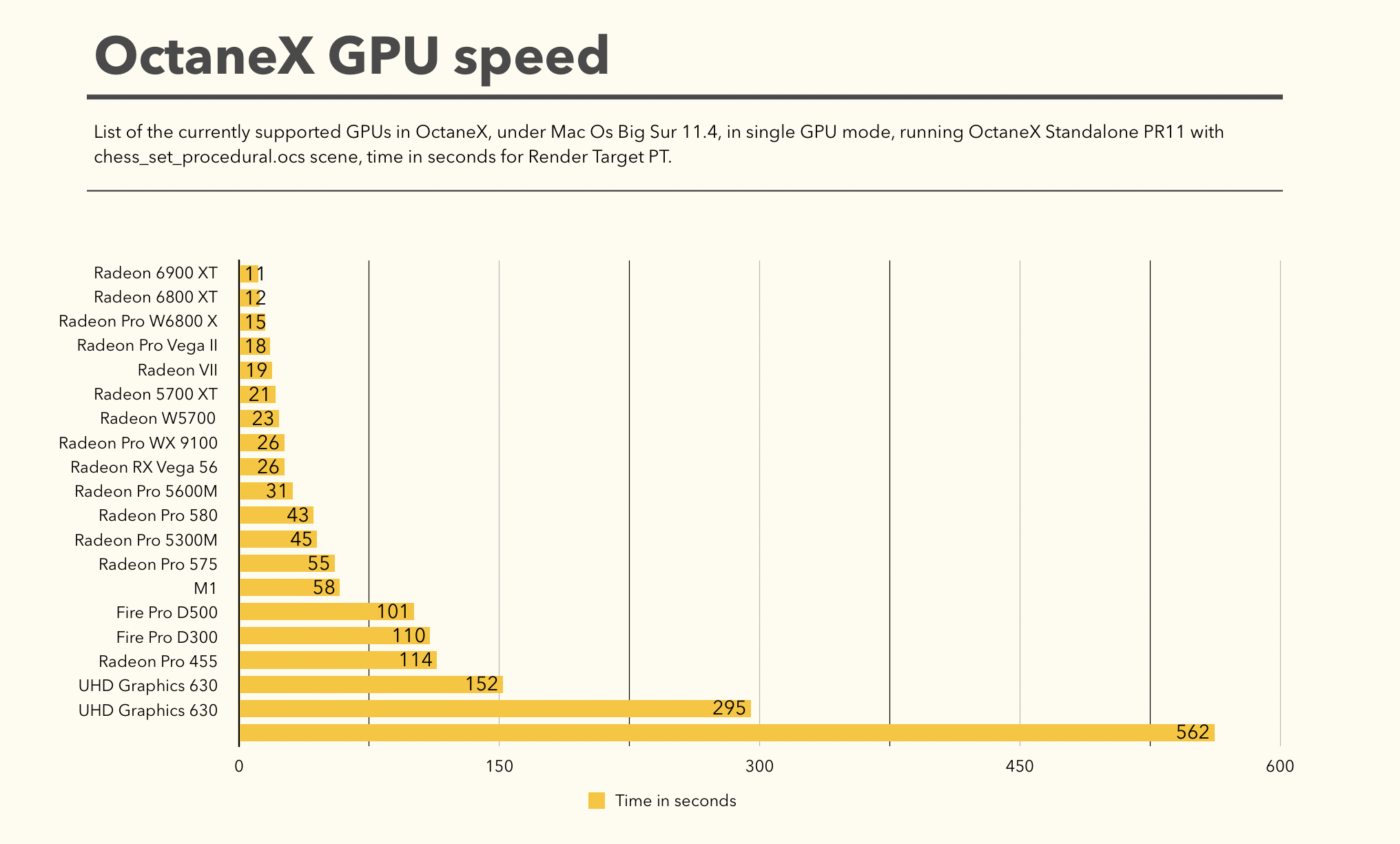

About eGPU, you can add one of the supported AMD GPUs in an eGPU box connected via Thunderbolt 3, here is a graph of speed in Standalone OctaneX under 11.4:
OctaneX scales linearly, so if you add a second GPU of the same type, the rendering speed will be 2x and so on.

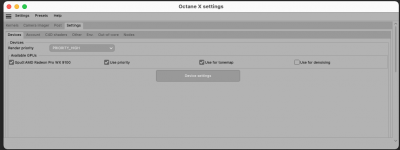

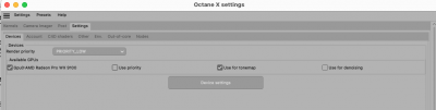

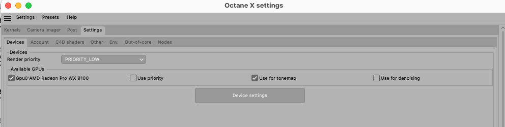

Hi, no matter how many times I check "low" priority it goes back to "high" or to unchecked "use priority".
According to Otoy´s recommendations when using one gpu : "low" and "use priority" should be checked.
Why does the plug-in reset it everytime?
I understand the wrong set-up causes instability and crashes, and when Cinema is opened back again the previous set-up might -sometimes- have been changed.
It will end up crashing again if one forgets to check it everytime C4D is started, and so back to the start until one remembers this set-up might have been absurdly changed.
Is there a solution for this?

Posts: 45
Joined: Fri Mar 01, 2019 10:02 am
Hi Beppe, tried your tip -several times- but it does not work, priority goes back to high as soon as C4D is closed.
Thanks anyway.
ñgo
macOS 12.7.6 (21H1320)
AMD RX6800 XT + Radeon Pro XW 9100
Posts: 10564
iRota wrote:Hi Beppe, tried your tip -several times- but it does not work, priority goes back to high as soon as C4D is closed.
Thanks anyway.
Weird, please write to help at otoy dot com asking for me.
