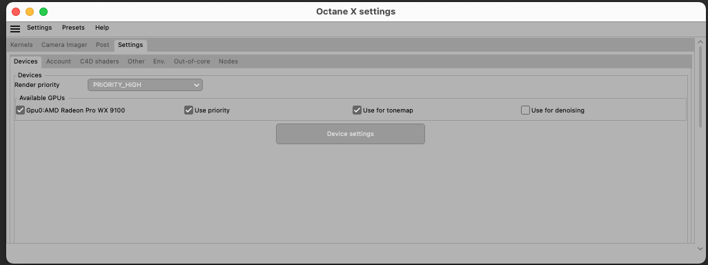

Hi, no matter how many times I check "low" priority it goes back to "high" or to unchecked "use priority".
According to Otoy´s recommendations when using one gpu : "low" and "use priority" should be checked.
Why does the plug-in reset it everytime?
I understand the wrong set-up causes instability and crashes, and when Cinema is opened back again the previous set-up might -sometimes- have been changed.
It will end up crashing again if one forgets to check it everytime C4D is started, and so back to the start until one remembers this set-up might have been absurdly changed.
Is there a solution for this?

@ joschmidthaler89:
the Fume error is not important, please check the path of the c4d scene, if on network path, try to move it in your local hd.

@ iRota:
please, try to delete the oct.dat file, at the following path:
`/Users/UserName/Library/Preferences/Maxon/Maxon Cinema 4D R2X_XXXXXXX/prefs/oct.dat`
ciao Beppe

Weird, please write to help at otoy dot com asking for me.iRota wrote:Hi Beppe, tried your tip -several times- but it does not work, priority goes back to high as soon as C4D is closed.
Thanks anyway.
ciao Beppe
