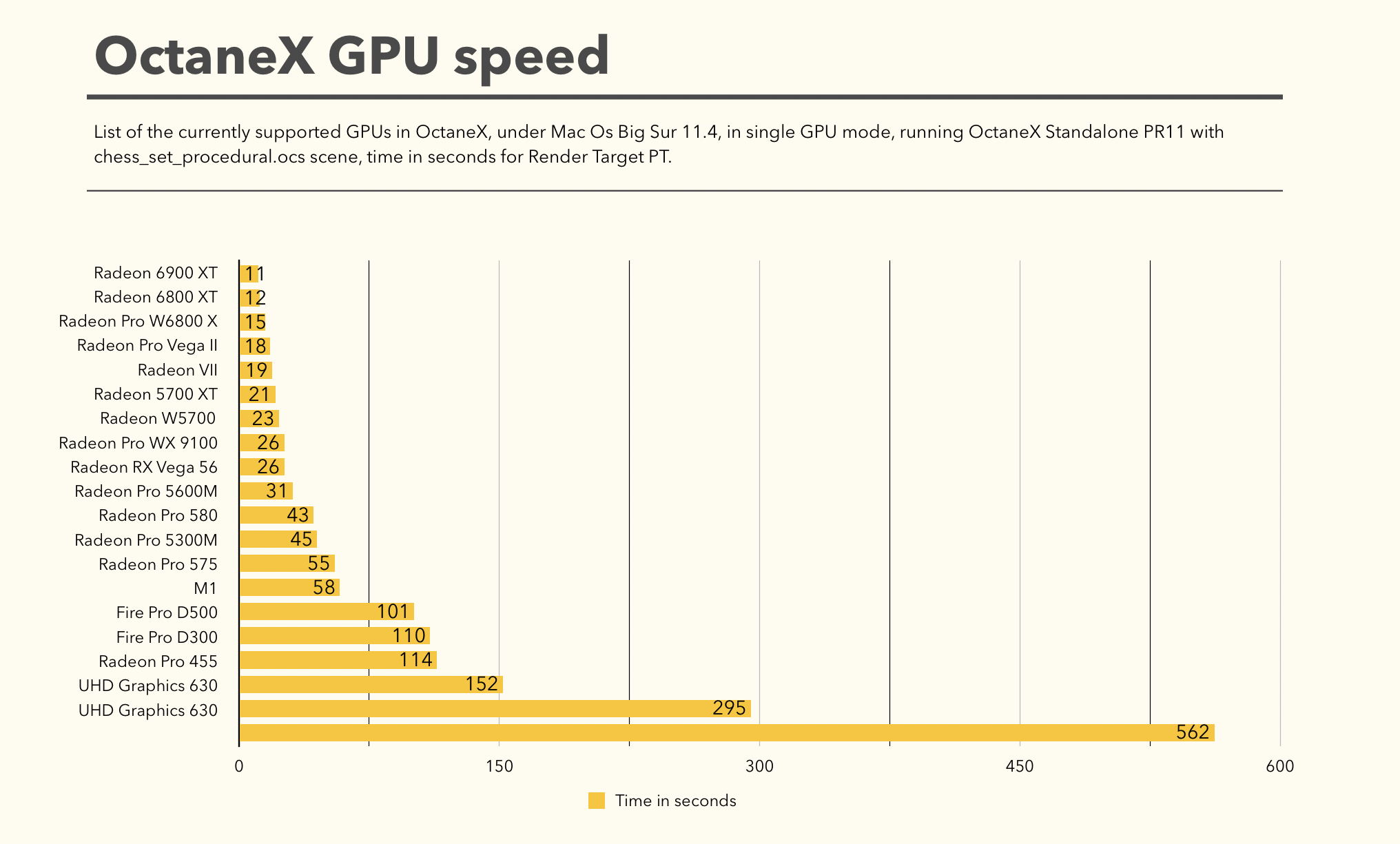

bepeg4d wrote: To have an idea of the performance, please download and install Standalone PR11, or OctaneX from Apple Store.
Then download the following .orbx scene, open it with Standalone, select the Render Target PT node to start rendering, and at the end, please share a complete screenshot of the result:
Here's my result (AMD Radeon PRO W6800X Duo 32 GB and AMD Radeon Pro Vega II Duo). I hope I did this right?

Posts: 10635
@bkindler: great, thanks :)
Do you mind to redo the test with only one W6800X GPU selected?
@askinskiy: Unfortunately Intel GPUs from 2015 are not supported, and please consider that Intel GPU is pretty slow, compared with AMD GPUs.
My suggestion is to use the Thunderbolt port to add an AMD eGPU to be used for GPU rendering only.
ciao Beppe

bepeg4d wrote:@bkindler: great, thanks :)
Of course not. Here's the Test: Just one AMD Radeon PRO W6800X.
Posts: 10635
Hi bkindler,
great :D
I have updated the chart:
Now we are missing only the AMD Radeon Pro W6900 X result.
Happy Mac GPU rendering,
ciao Beppe
