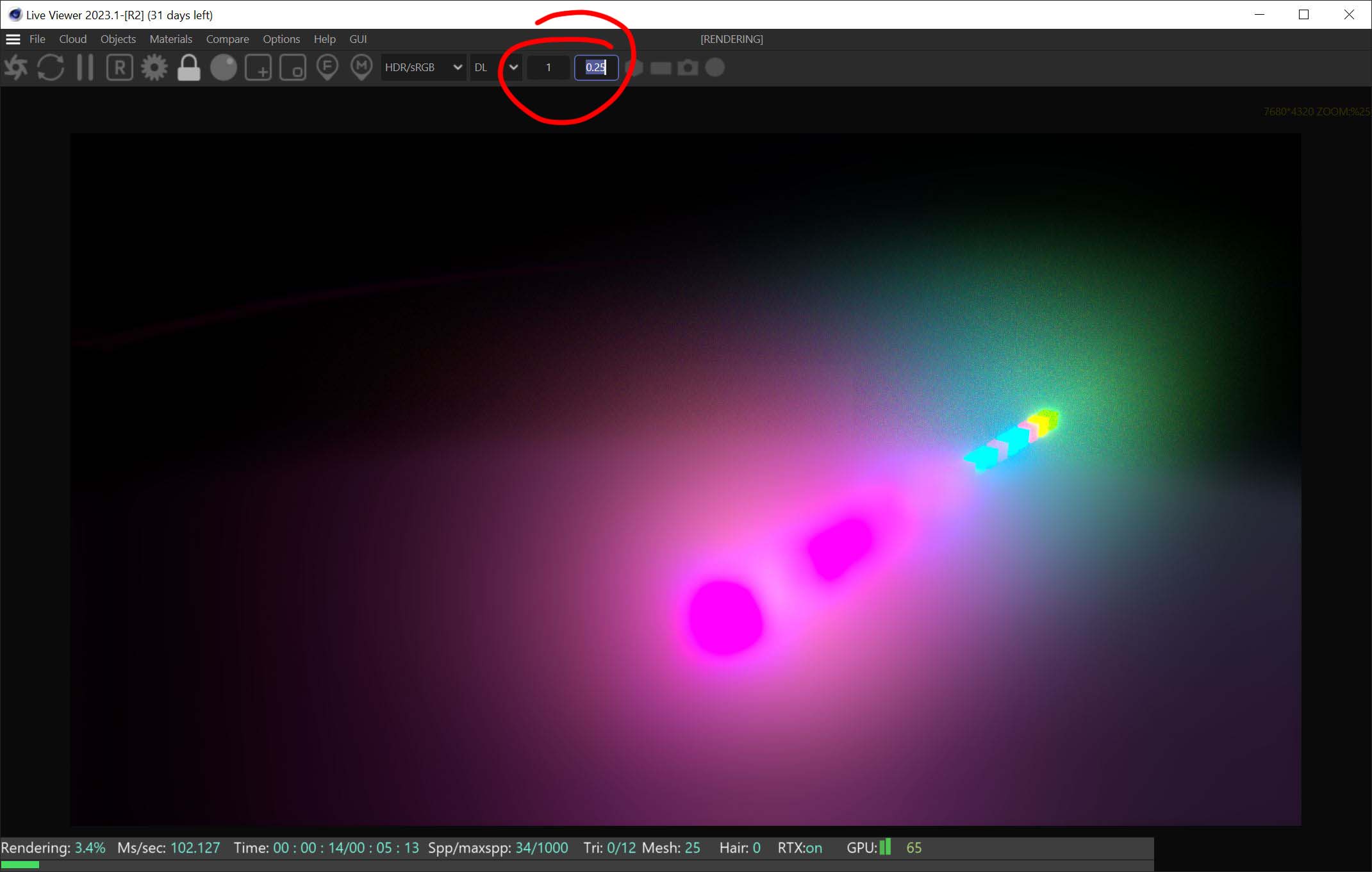

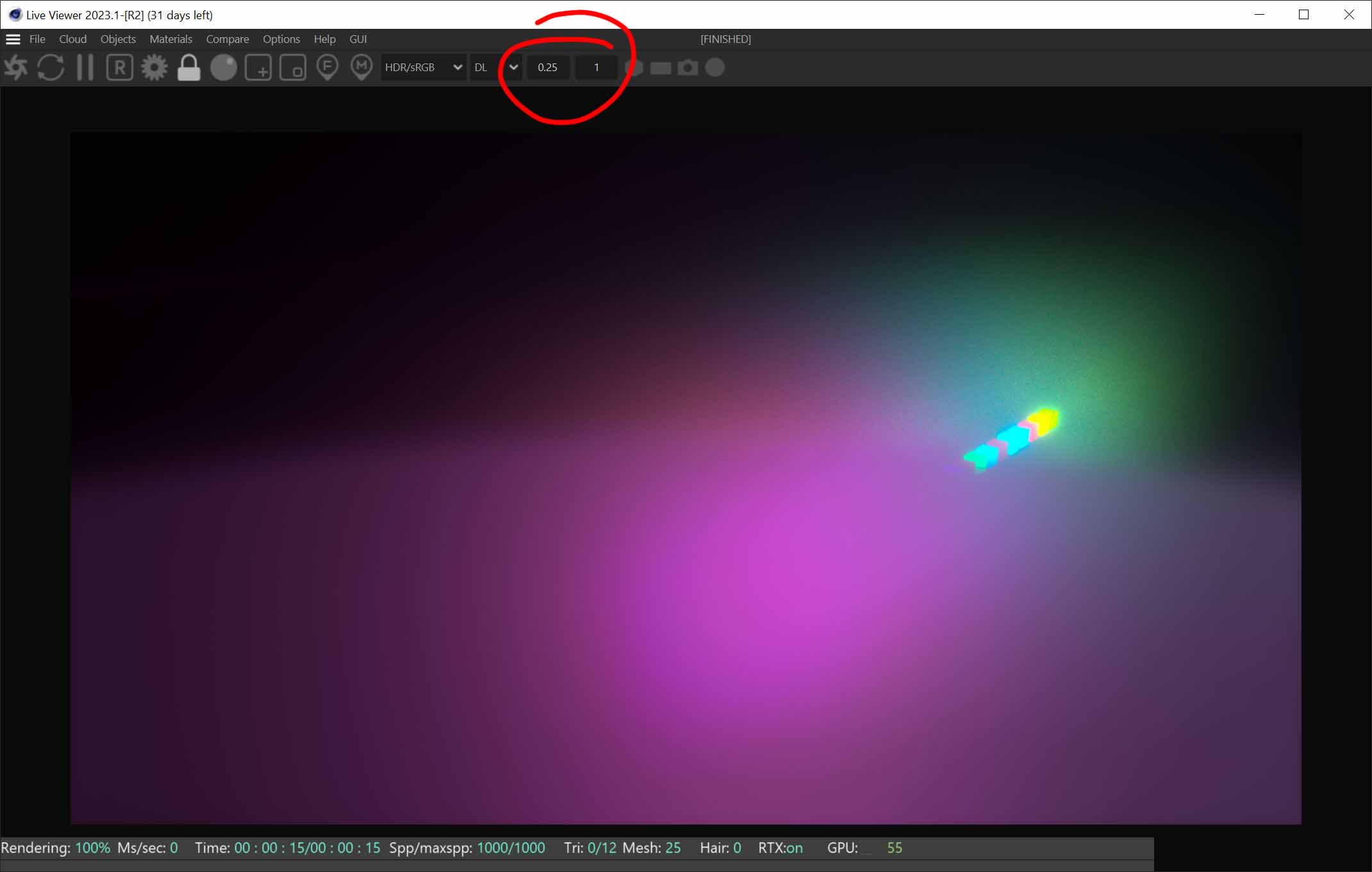

Quick question regarding a possible bug with the post fog; When I change the resolution to do a final high quality render, the fog does not scale with the resolution and thus changes in appearance. This is also visible when using the live viewer. Is this a bug or am I missing a setting? I thought the scale with film checkbox would help but I don't see a difference. Is it possible to link these values, so the resolution does not make a difference?
C4D test file uploaded here: https://we.tl/t-Gw6ZOKgFtL (The extra volume medium does not make a difference)

Tim_Twisted wrote:Hi Ahmet,
Appearance is changing with resolution in case. I don't know is there something missing on my side, I'll talk to core team. But you can make last tweaks at full res with canvas scale<1.0. It's not a good idea, I know.
