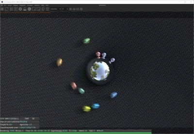

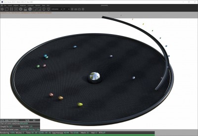

MichaelJeffreyVance wrote:Hi I have a test scene that uses Cinema 2024 new Rigid Body simulation system and I can't get motion blur to render in the Picture Viewer. Please see attached.
OctaneMotionBlurMV3.zip
It's not working because you need to cache the dynamics. We are using a temporal copy of scene for data and it requires to have data. Caching provides that. See the picture!
Ah I see. It has to be cached. Thanks. That seems a tinsy bit inconvenient, but having the ability is the important thing.
TBF, caching should always be the go to solution since it gives you the ability to rerender the exact same simullation and/or just a few frames of it.

Ah ok, sorry. Didn't mean to cause sorrow. I don't know the extenuating circumstances or what it took to make it possible but I am just happy now that I know I need to cache it first, the performance is even much better than I ever expected. I discovered after caching that I am able to see the motion blur in the Live Viewer even as the file plays, which is just amazing. :o I never expected that so great job there.

Because of the nature of the effect and lack of obtaining the motion data that is the way I have implemented. Cumulative calculation systems will not support random access to different frames. So caching ia a must, nothing new to 2024. I would have a Maxon support for motion data for any objects at any time. But they never offered this option to 3rd parties. So hearing this is a bit sorrowful for me, because I've spent much time to solve the problems

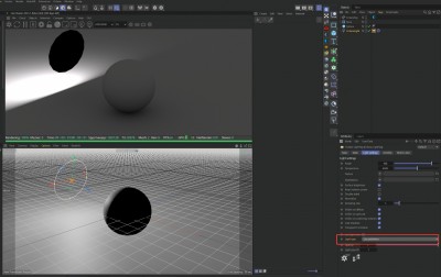

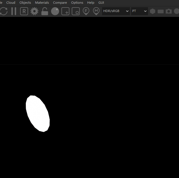

Change the shape of the light to a disk and the direction of the light will be reversed
Posts: 10637
confirmed, but please note that Disk primitive is supported only by new Analytic Light, so to fix it, you need to change the Light type, from "Use primitives" to "Analytic":
To recap:
- Default = only Rectangle
- Use primitives = Rectangle, Sphere
- Analytic = Rectangle, Sphere, Disk, Tube
ciao,
Beppe

bepeg4d wrote:Hi,
To recap:
ciao,
Beppe
Or switch to "default".

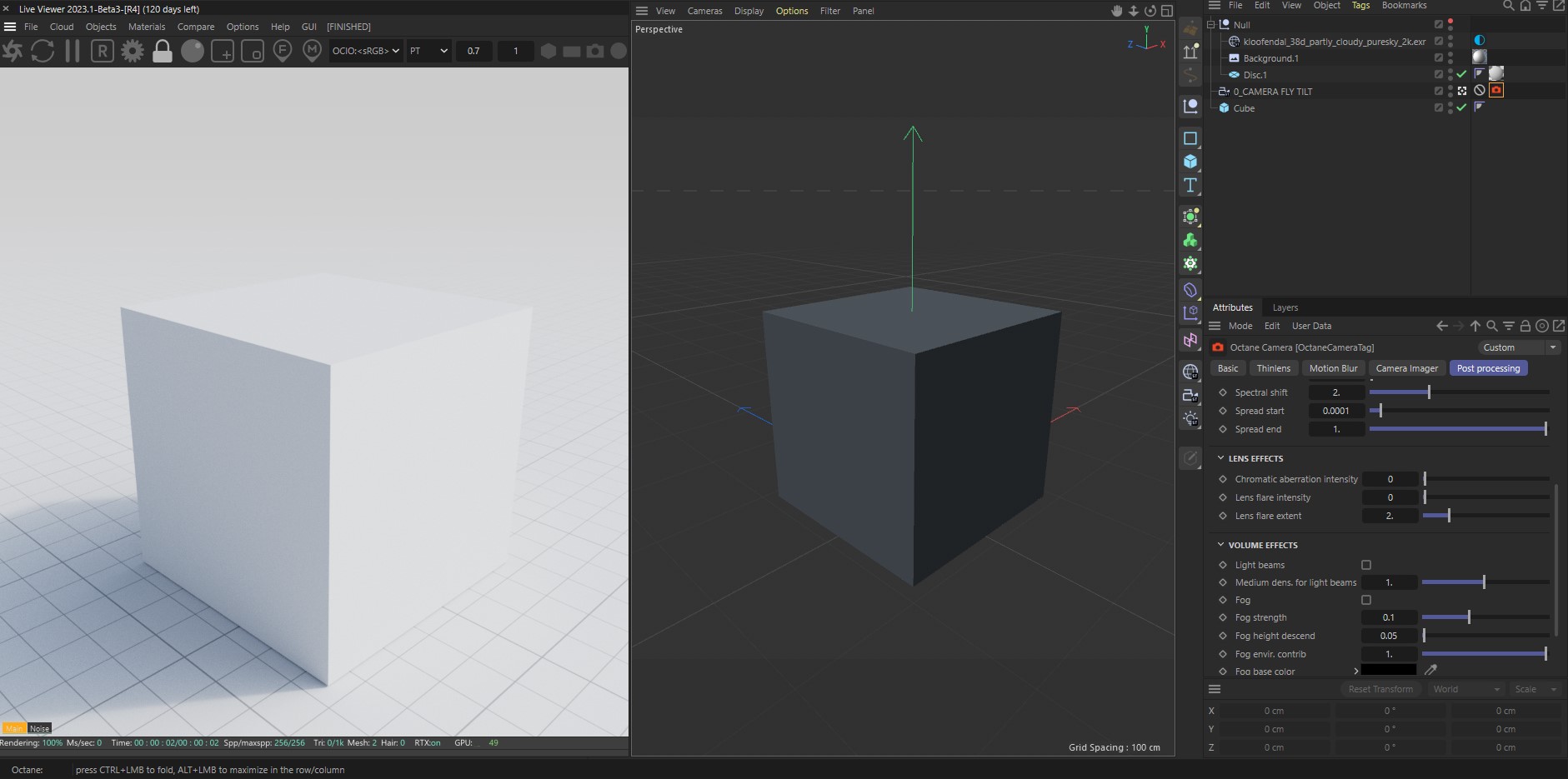

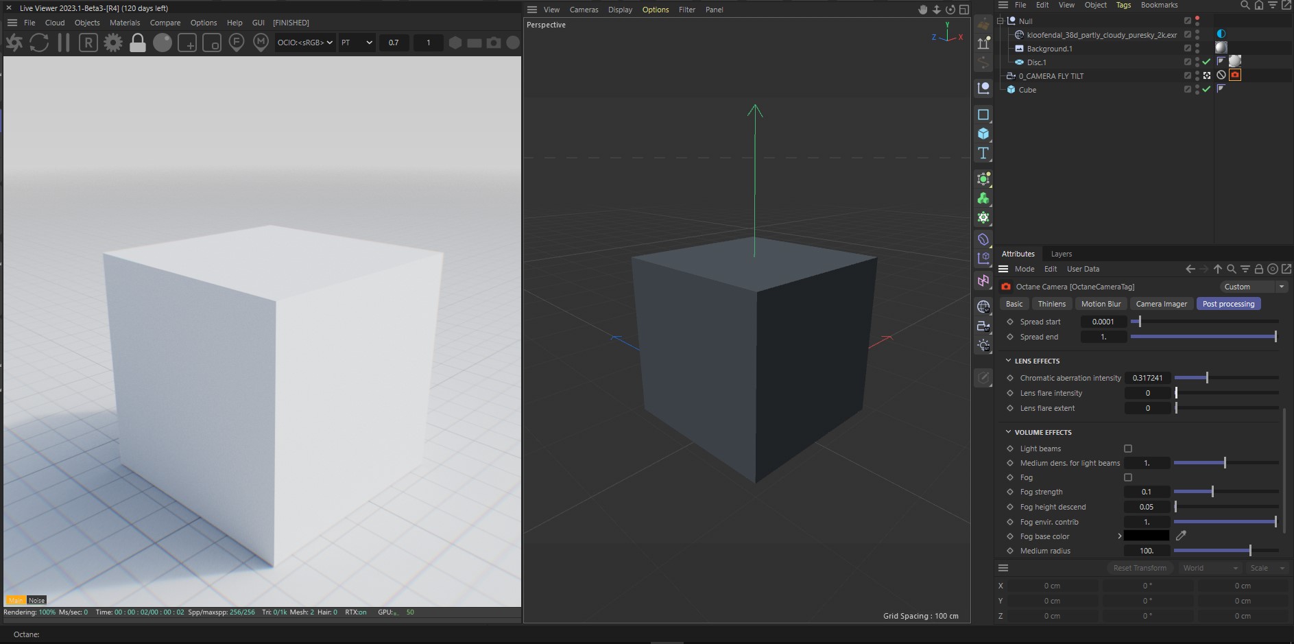

Until now I realized C4D background object is not exported to Octane SA.
That is why I am posting here:
Chromatic aberration kind of messes a bit with aplha background + C4D background object. In this case it darkens the background a bit all as soon as chromatic kicks in above any value of 0.
Take a look at the pictures.
PS 1.: I realize it messes SA alpha channel too, so it is not really C4D bacground object... it's kind of something maybe Otoy could look into.
PS 2.: I managed to restructure the alpha gradient inside the ground shader and it works great now!

Kalua wrote:This build looks great, Aoktar! THanks!
I'm curious how you using C4D background object because it completely doesn't work for me. Why not to use Octane environment texture instead ?
Thank you Aoktar for fast update !
Background object is not something that can be exported
